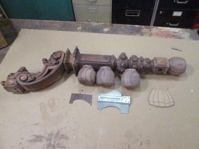

Although the rosewood cut easily the shavings are small due to the wood hardness.  This morning it took over an hour to vacuum the shop - the dust was everywhere.  After one leg was made and looked proportional - the wire gauge provided a shape from that leg that was copied onto a piece of Formica to use at the lathe.  It would have been better to turn a dowel at the top of each leg but a dowel would have been in the way while figuring out the form and proportions.  A sketch of the toes I have in mind that don't seem too difficult is pictured. 4 feet are done and ready to be attached.
The toes are done - the foot on the right was sprayed with water to show the natural color.  The Brazilian Rosewood I used for some of the parts previously was very red and I'm thinking I'll need to bleach those pieces before finishing - the chair's color after stripping and sanding is that faded rosewood color.  Installed on the bottom of each leg is a small thin piece with a bull nose edge to make the transition look better.

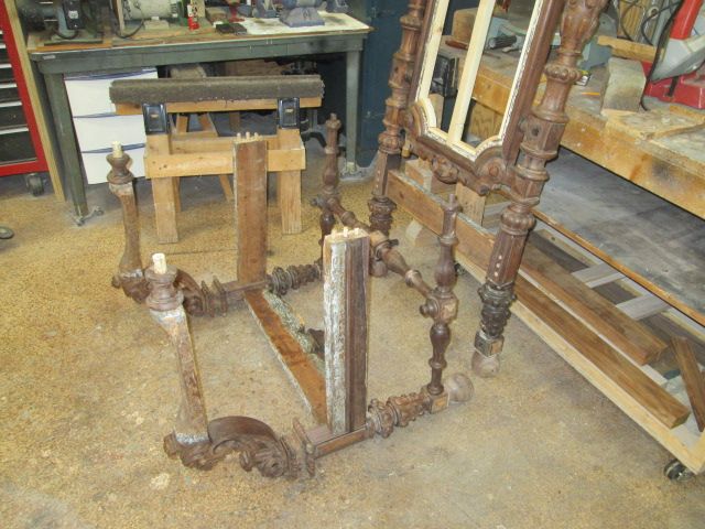

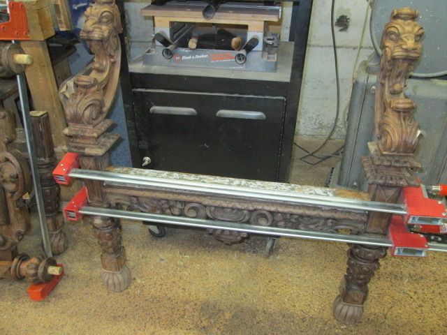

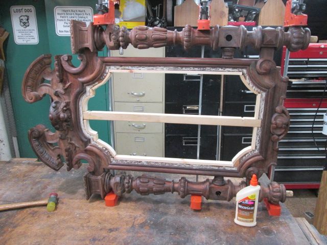

Sectional glue ups - pilasters glued up to backrest and two back legs glued to back seat rail - yellow glue

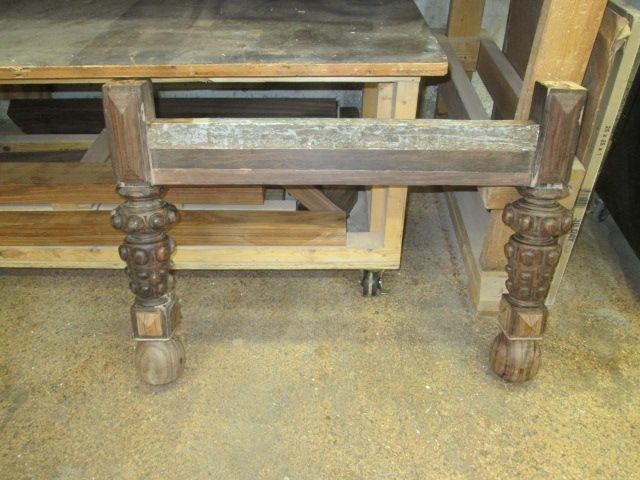

Front seat rail and both arm rest supports - glued up

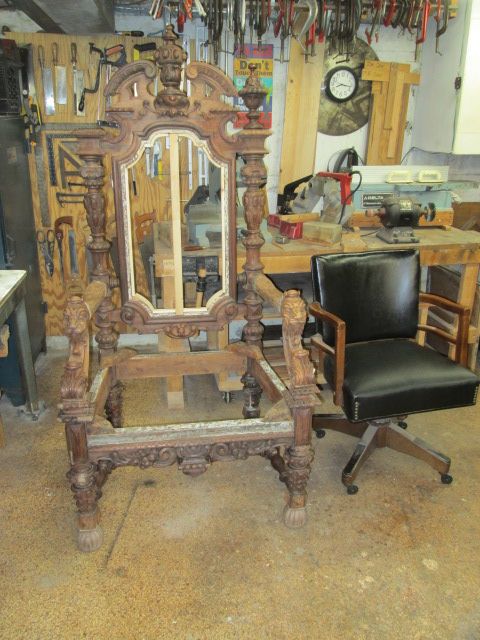

Dry fit before final glue up
QuoteDry fit before final glue up
Coward. LOL. Looking good.
Darren if I glue up this chair crooked Gene and Keith will never let me forget it.  I'm hoping to get to it today - all the dowels fit nicely during the dry run - just need glue and clamps

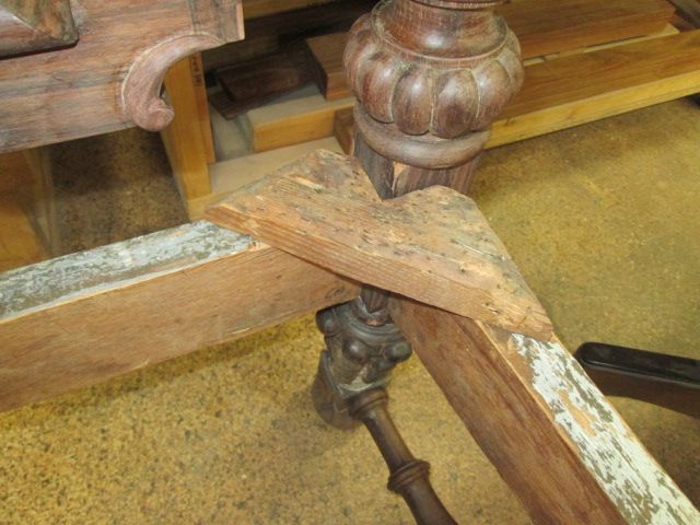

Found a spot on the floor that was level two ways - couldn't do the glue up on top of the table saw the way I like too.  After clamping up the diagonals were equal - all good - used yellow glue.  Next need to make 4 new corner blocks.  They sit on top of the rails - close to 2 inches thick.  Might have to make thick homemade fox edge to fill the empty space in between the corner blocks.

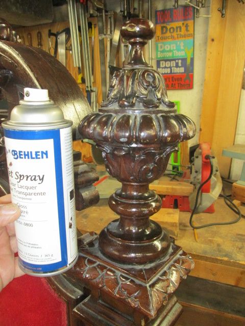

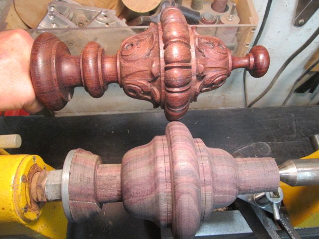

Started to make the missing finial - going to make it in three pieces then join it together - the middle is turned and ready for carving
