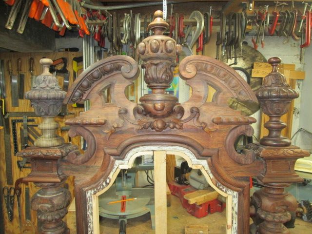

The lacquer you are using, does it give that antique look all in one application or do you spray something on it first? That's an awesome looking finial Steve.
I do use that lacquer for touch up- but held the can there only to show the size of the finial.  Spraying clear lacquer over rosewood that's been stripped will show the true color of the wood.  Many of the replacement pieces may be too red since the chair in general has faded to a golden orange color.  It will need selective staining when the time comes. I don't want an antique finish - I want to see the grain.
Due to the oil in rosewood after lightly staining with a dye it will be sprayed first with seal coat then the clear lacquer.  I do like lacquer very much and use it for most everything I do.  As far as replicating the antique look on any piece;  it excels at that.  With a coat of seal coat followed by clear solvent lacquer you can achieve a finish of any luster including gloss without the heavy look of an oil varnish that also needs multiple coats sanded back to have an unbroken appearance of gloss.  Behlens and Mohawk are very good products.  Glazes and toning are another way of building a finish to appear old, soiled, tarnished, and dirty.  When you look at the finial next to the can before it was stripped you can't even see the grain of the wood  from years of soil, linseed polishing, and waxes

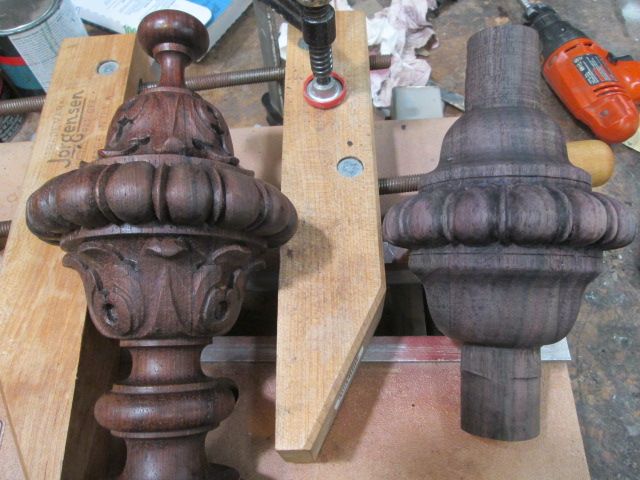

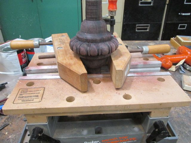

A workmate and wood clamp was necessary to hold the turning for carving. The large ring is done -  The wood is so hard you can't hold it with one hand and push the chisel with the other.  Used a 3/8 wood chisel for the carving and a auriou riffler for clean up.

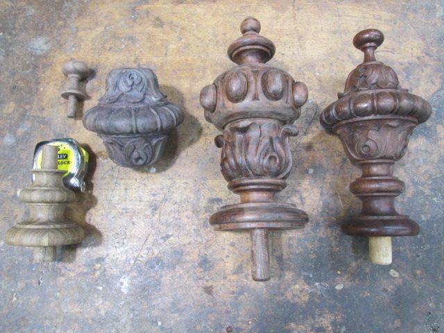

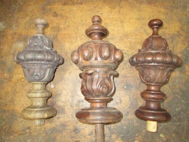

Finally finished making the missing finial.  Made it in three pieces - just seemed easier that way.  The new pieces are rosewood but the natural color really varied -it will need some toning to get it to blend.  I have to buy some castors for the legs.  I want something heavy and I've been looking through the faultless catalog.  After I get casters I think it's best to put the springs back before some bleaching and applying finish.  Any suggestions - should I use synthetic straps or go with the regular red burlap.  I think the synthetic is better - is that right ?    Photobucket was a real pain to load 3 photos - took almost 30 minutes.
Once you get that color matched, I don't think anyone could tell that one was re-made to match. Really superb work.

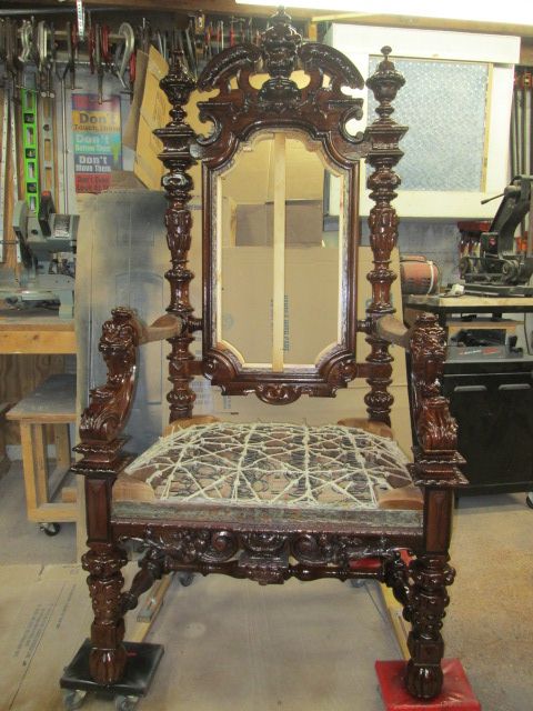

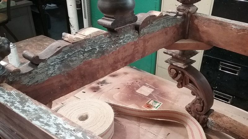

I'm going to do the seat springs before finishing the chair due to the difficultly handling this size chair. I don't want to bruise the new finish while doing the seat.  I don't remember how the  straps were attached to the front rail - not seeing screw holes for a rail that was attached below the carvings.  I'm sure the straps weren't attached to the high + low of the carvings. Maybe the straps were just folded over and tacked into the face.   Does adding a rail even with the side rails sound right to you ?
I know you are trying to keep this project original but sometimes back then they gave no consideration to the upholsterer. I would add the rail just to make it easier.
Thanks - I did add the rail - I was a little hesitant to do it so as not to crowd the springs (16) but they all fit when I placed them on top of the webbing -
I placed the new rail slightly below the side rails so that the webbing is hidden when you view the carved rail from the front

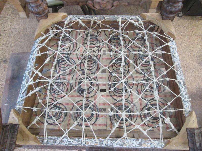

Finally finished the springs.  16 springs - I replaced the older ones that were rusted out.  Interestingly the previous center springs were softer than the edge springs - I guess so the sides wouldn't collapse in and the center would remain soft. For the new springs I used the same strength springs throughout and nearly a roll of spring twine.  Now I need to do some finishing work.  I'll cover the springs.  Some bleaching on the woods that never got lighter from the sun - seal, stain, and lacquer top coats.  I had some maroon mohair left over from another job but no the Mrs. wants to pick out something different.  She asks me how would paisley look - I didn't answer her
