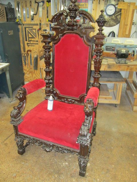

New project came in today.  Repair, refinish and fabric.  Throne chair - from a Church.  Can't say I ever saw one this large - takes up the whole shop.
Thank goodness they are not in a rush - their building is being overhauled and expanded - will take a year for the building renovation.  Will bill something but not what it should cost a COD customer.  I think it's rosewood - I have to strip off some finish to see the wood more clearly. Maybe walnut with a red stain or Indian rosewood ?  It's a pain -
Wish someone else worked here besides me !  One of those jobs you don't know where to start

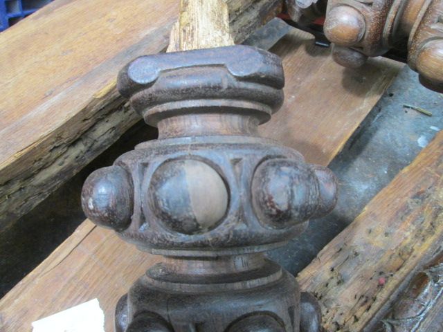

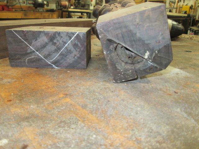

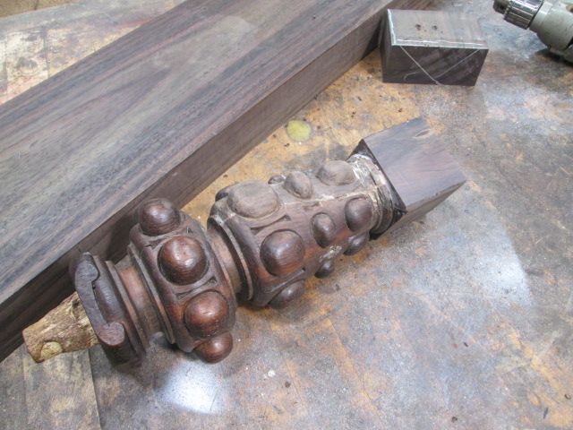

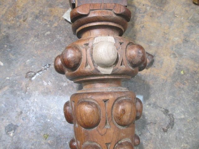

I started to work on this chair finally.  East Indian rosewood - terrible stuff - tears and sheds to splinters when carving - also very hard dulling the edges of the tools.  I purchased a 36 in. long x 2-1/2 thick x 7 inches wide piece of this lumber to make parts - $ 80.00.  On the leg I replaced half of the bottom block and a section of the buttons that were torn out and lost that were 1-1/2 in. wide and the length of the leg. 3 buttons were missing and the wood below.  The the void was 1in. below the buttons.  A little more fine tuning - fortunately it's a back leg positioned on the inside

Slow going - replaced half a button - many damages and the chair has to come completely apart.  The joints have to be reglued.  I'll post other photos - not sure if anyone is still out there to view the photos?
When I strip the leg the liquid paint remover will stain the new additions with some of the original color.  It's a nice technique if you can repair before stripping.

I searched Throne chair - no plumbing -  and found Shaq in a gilded chair at a basketball game.  He looks a little snug in it but if he had my chair he'd have extra room.  Mine stands 6 feet tall - the seat is 30 in. x 30 in.  Loose leaf would be a fortune to cover the chair.  I think a pack is running over $ 1000.00.
There are 16 seat springs and three mini coil springs on the top of each arm.  Still need fabric suggestions although that plateau is a year away at my pace. Kody will be done before me lol

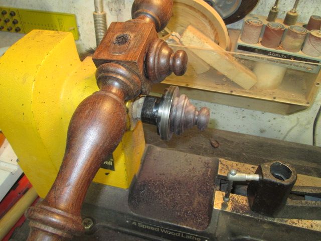

This is a lower rail stretcher - one turned decorative knob was missing.  I made one today - not nice wood to turn - no clean shaving at all

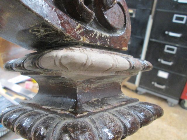

Haven't had time to do much work.  This is the front deck rail - secondary wood backer pieces were missing behind the carved decoration.

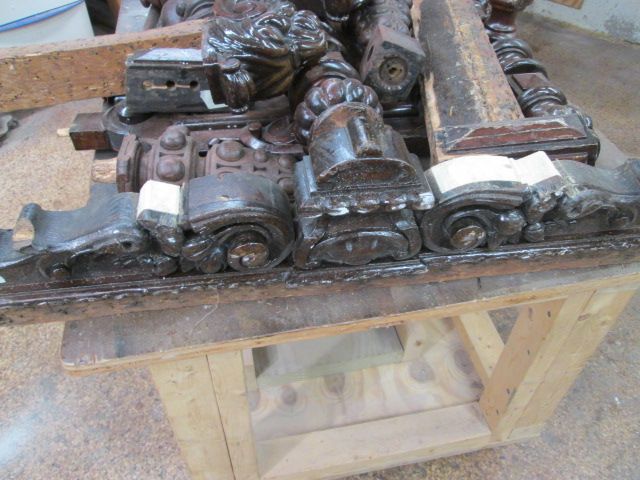

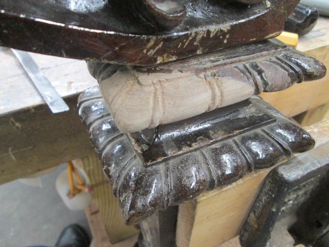

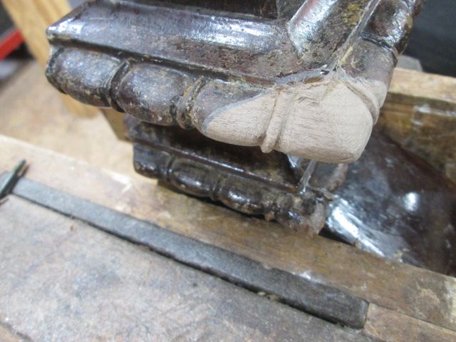

Progress today - replace lost corner - there are 5 more like this to repair-  I used walnut because the rosewood was just too hard to carve - I can color match the walnut to blend in.  Carving rosewood takes hours longer and not worth it for me.  This corner took one hour and still needs a little fine tuning.
