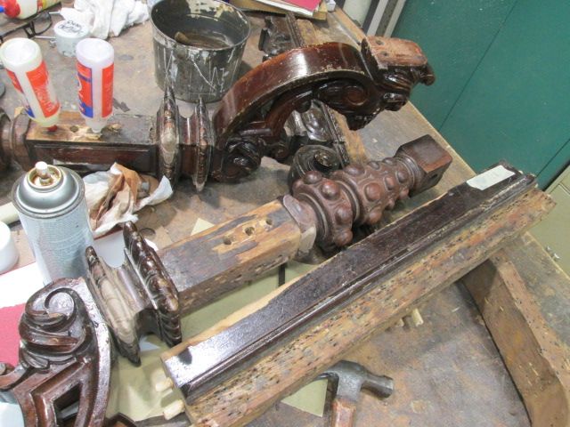

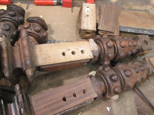

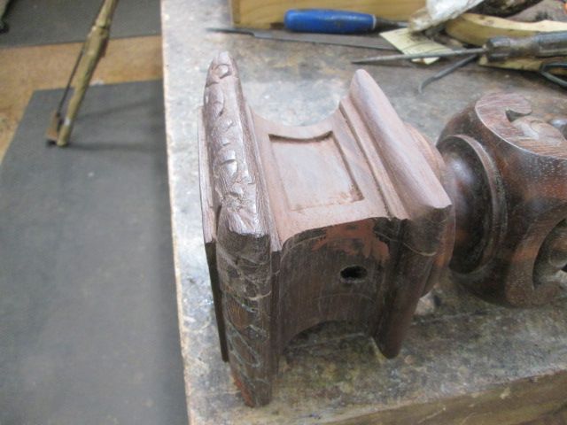

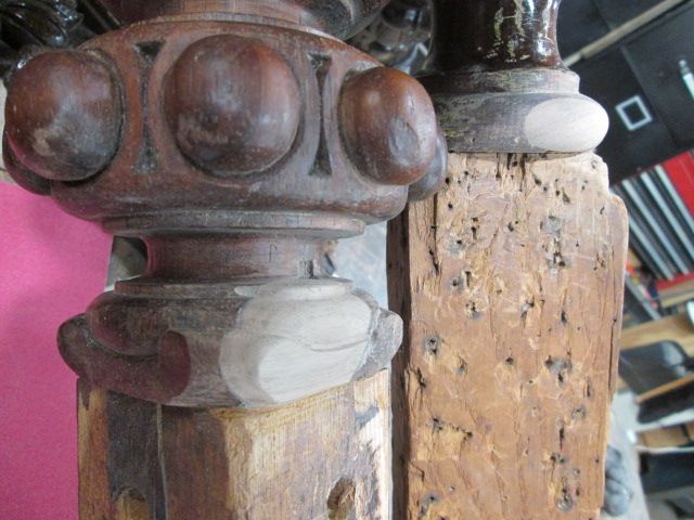

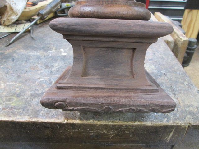

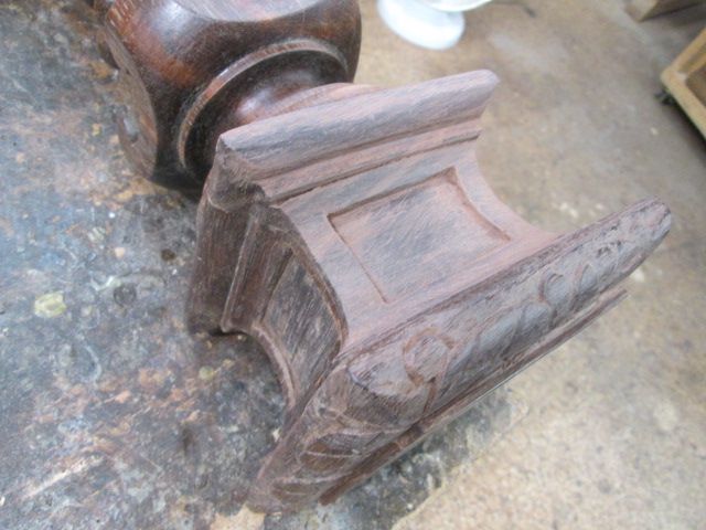

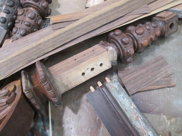

All the repair + replacement pieces are done.  I need to start veneering the long side rails and areas of the main leg where the side rails dowel into

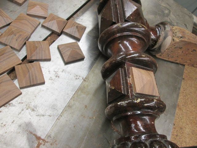

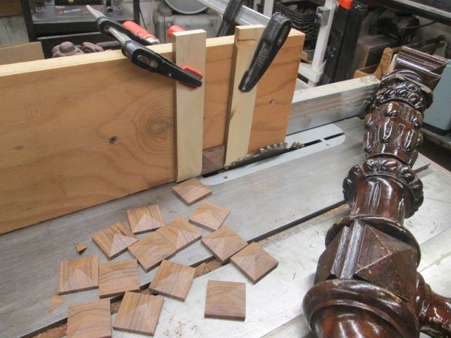

Missing about 16 small square pyramid shaped elements and two longer shaped ones.  Back to the rosewood - because there's no carving - the saw blade makes short work of this decoration.  The blade is tilted 20 degrees and the tenon jig rides on top of my fence -

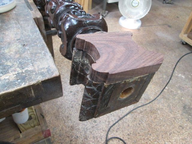

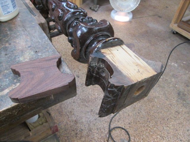

The top of each back post had been cut off maybe to fit against a wall - found a nice piece of Brazilian Rosewood - enough for both chair posts.

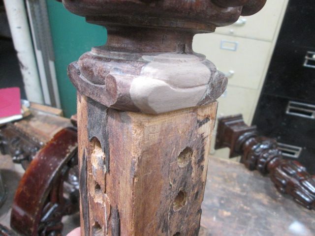

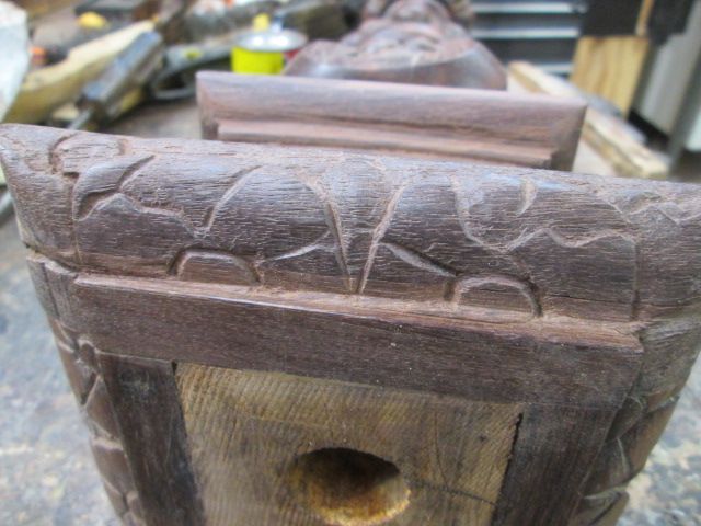

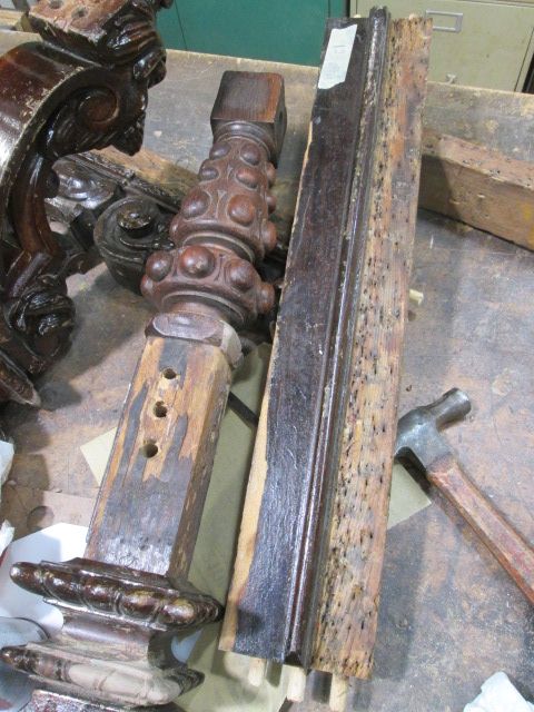

Little progress - re-veneering the posts where the side and back rails are doweled into the legs.  Previously hide glue but it failed when the rail loosened. 5 veneered areas were bad which I chiesled away down to the oak substrate.  I had some old rosewood veneers - .040 thickness which I glued down with urea resin to avoid any movement.
