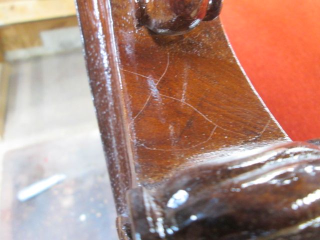

Things were going good for so long but cant say that today.  Two problems I'm mad about -  First my choice to use shellac as a sealer was fine but I sprayed too much in places thinking I needed to really seal the oil of the rosewood.  A few horizontal places pooled and being too thick I got some crack lines.  Shellac doesn't dry as fast as lacquer and I over coated shellac coats without enough dry time.   It's been about two - three weeks since the finishing was completed - I have three areas with cracks hopefully there won't be more.  The other issue was the leftover piece of red mohair I'm using.  When I unrolled the fabric there was a line I couldn't get out so I had to measure up 10 inches before cutting out the seat plate.  I only have about two yards to work with.  After putting the seat on I still have enough fabric but not enough to run it in the same direction as the shading on the seat.

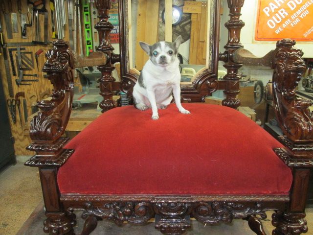

This chair, I stained the legs with a chestnut brown and then finished with a couple 'regular' coats of shellac. Looks good, eh?
http://gdurl.com/dbi1

Steve, in looking at the first picture: I usually get any bugs off the furniture before I start working on it. :-)
Just joking to ease the loss of my yellow lab of 12 years who died two days ago. They do grab your heart, no matter what size they come in. This was our 3rd and final lab. Our next dog will be ceramic. (I know. I've been told that I'm saying that now but just wait awhile.)

At least the Mohair is not as bad as velvet when it comes to the shading issues.   The cracks I'll dye to conceal for now but maybe in a few months after all the curing I'll wash down the finish in those areas - reseal and recoat with a lot less finish.  Buick will send me some of his shellac brew to try - I'm sure the shellac build was one of the problems.  On the positive side a 125 year old chair with a few distressing cracks isn't going to get me down too much -

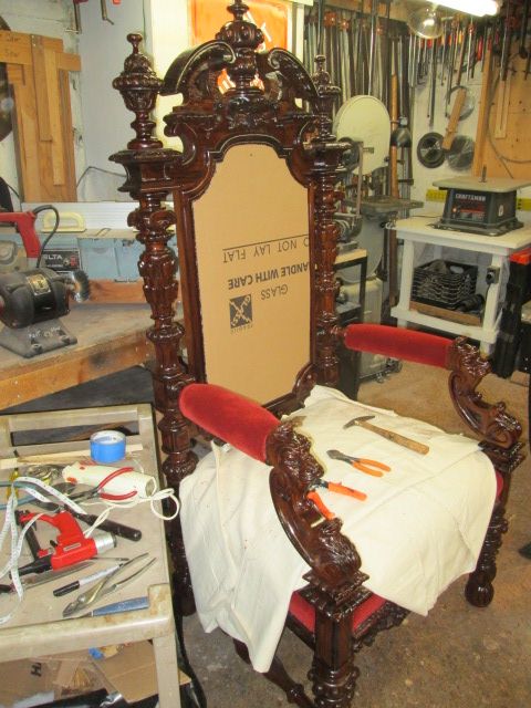

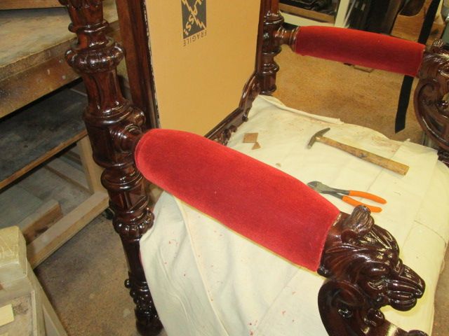

The arms are done - I won't outline the arms with gimp.  I made a cardboard template for the inside backrest to draw center lines for laying out the buttons.  I was going to try to tuft the buttons - never did it before - but when I was doing a test with a scrap piece of mohair I found that when you fold the mohair over you see deep into the fabric substrate and it doesn't look nice.  Deep buttons will be fine - learning tufting will have to wait.  The final height of the seat came a little high.  I'm 5-10 and when I sat back my feet were off the floor but i guess this chair is really meant for someone 6-5 or more.  Big chair for a big person.  Nearing the end and it will be nice to have the other half of my shop back from this giant chair and the space it takes up.  The next one definitely goes in the reclaimed lumber pile
Nice job Steve and I know you are joking about the lumber pile. A chair like that needs to be saved. Just wondering why not make the back tight with no buttons? Will you be selling this chair?
