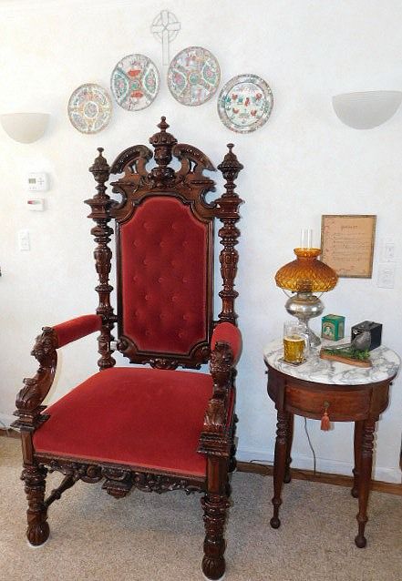

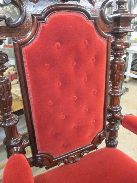

Ed the original fabric on the chair had a tight back but after looking at examples on line they all have button backs.  I guess more eye candy is the norm with these chairs.
The chair will stay in the Family - my Son & daughter in law want it once they have a place big enough.  If it didn't have the lion faces maybe it would make a nice Celebrants chair ?  In all the images I viewed on line I have yet to find a duplicate and there were no hall marks inside on the rails.

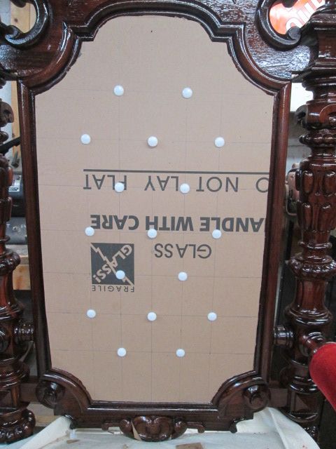

I had a jar of nylon chair glides and used them to lay out the buttons.  Looks ok to me - there was nothing previous to go by

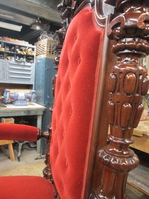

Very lucky my good buddy Jose stopped by when I was getting ready to start the back.  He told me to go sit at the other end of the shop and make buttons - Jose is a life long upholsterer and he said if I did the back I'd screw it up - I didn't disagree with him.  Interesting how he approached the back with many changes to what I had in mind.  First he started with straps on the inside back rest.  He wanted to use synthetic instead of the red webbing I had in mind.  He wanted less of a projecting fold.  He took fox edge which I wasn't considering and outlined the edges so that the foam wouldn't round over near the edge, he turned the fox edge around with the tab facing the finished woodwork ?  Had no idea what he was doing ? .  This left room for the gimp at the end.  Straps, than foam 2 inch - I wanted tight buttons however he drilled out the foam with a 3/4 inch hole saw so the buttons would press in further I didn't think it was necessary - he did.   The cardboard template worked good for laying out the pattern and the pine wood around the edges worked out well to hold the strapping back enough so the gimp had room and went on nicely.  I put the pine because I thought the existing 1/2 inch edge wouldn't hold all the staples without breaking apart but this pine wood also allowed new room for a very neat gimp job.  This chair would never have been as nice if Jose didn't stop by -  upholstery by a pro was the craftsmanship necessary to have the best result.  Thanks Jose -

To begin, what size buttons are those?
Ian I read it over and can't blame you for not knowing what the heck I was talking about.
The buttons are 30 with the eyelid for button twine.  While Jose pulled the twine from the back I pressed the face of the button to the depth before he tied it off.

What is a "fox edge"?
And as far as the webbing, I think you're talking about the black stuff. I am not sure what difference this makes except that it is sort of elastic.
The fox edge is a heavy rolled type of piping used on the front and side edges of the raw wood frame before the foam or cotton. It softens the hard edge of the wood.
The black synthetic is thinner so when it's folded over to staple it makes less of a bump -
Maybe some refer to fox edge by another name but that's the only name I've come across for that material

Really nice job Steve. I bet your glad its done.
Thanks Ed - yes it was wearing on me knowing the work it needed and I had my regular work to do.  Toward the end it was starting to feel like a chore.  Anyway thinking back I was going to cut up the wood for smaller projects - doing this giant restoration wasn't my first choice.  After I got it back to the shop I thought to myself this chair has been around 150 years - you won't see many like it - and who knows what Priest celebrated Mass seated in this chair.  Maybe the Arch Bishop ?  Dare I say a Pope ?  Maybe one day I'll find a picture with John Paul seated in this chair.  I'm very glad it's done - my Wife fixed up a place in the L/R - hung plates and looks at it as sculpture - I see woodworking craftsmanship from an earlier period when high quality mattered.  This is my last entry - I have the chair until my Son and DIL trade me for a grandchild.
Beautiful work. I am most impressed with all the wood repair you did.
I think you got the outlay of the tufted buttons perfect. I can't imagine the original being any different.
And a well deserved glass of your favorite brew on the side table.
I wondered who would notice - that's my favorite - had to put it down to take the photo -  Thanks for the kind words -
