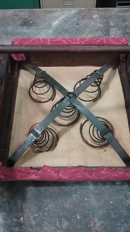

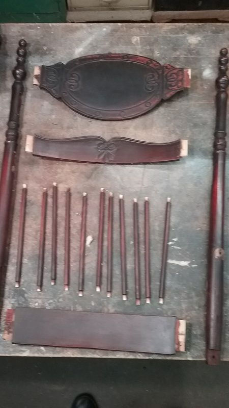

Old customer called and asked if I could come pick up a rocker to restore.  While I was picking it up she said - by the way I'm doing this for my Husbands birthday - it was his Mother's.
It's a surprise and can i have it back in 3 weeks.  I said fine but when I got it to the shop it's turning into a dozen little repairs before i can even strip it.  The springs are tearing through and I'm thinking of re-enforcing the underside of the fabric without ripping it all out.  Maybe synthetic horse hair on top, muslin, dacron, and the new fabric.

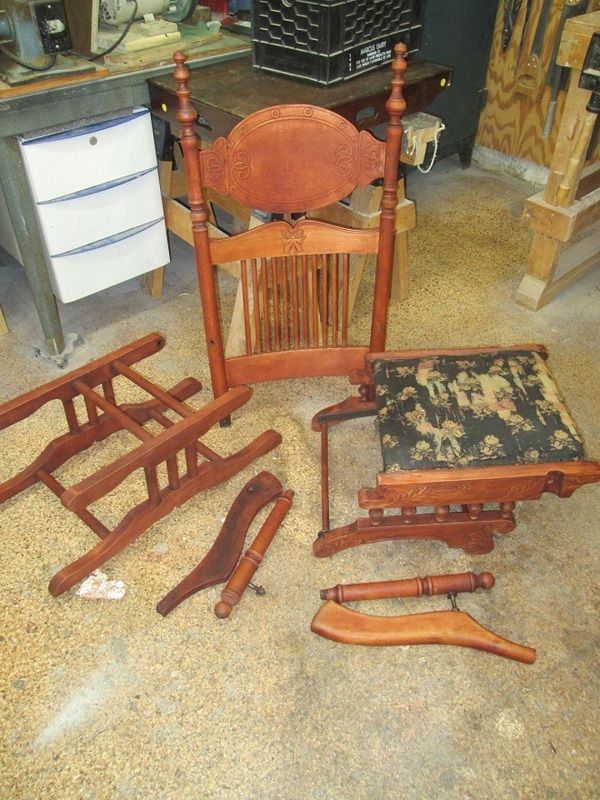

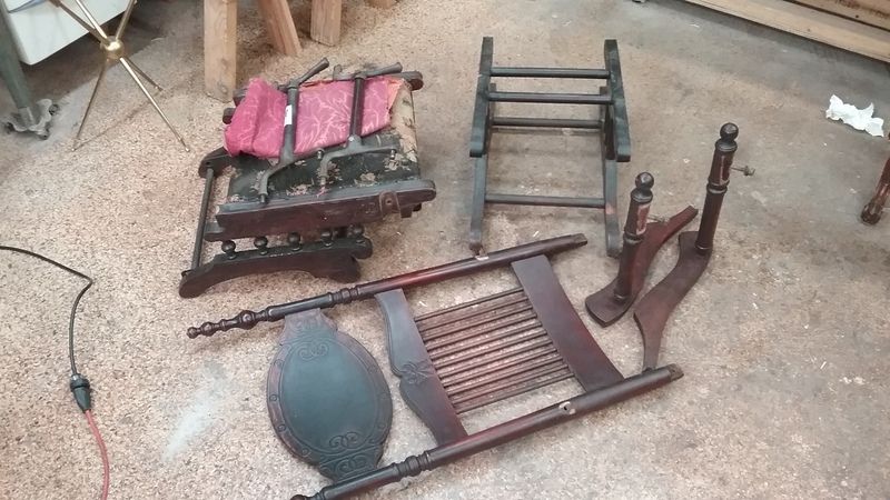

The old finish is stripped down.  Slid some fabric under one spring that was tearing through.  I think I will re-enforce the others springs as well.  That old finish was a pain.  I painted on the stripper and it loosened the varnish but I could not use the putty knife too much because of the incised carvings.  Comes down to scrubbing with steel wool and thinners.  Hand stripping is a pain.  The old finish although dissolved from the remover clings to the wood like glue.  I envy the guys with strip tanks.
The old color was a dye and a strong one.  Probably will have to stick with a cherry or mahogany color stain because the red is not going away unless I want to add bleaching steps to this job. - And I don't want to add more steps.  Didn't even want to take the seat apart.  I'll try to get through the sanding over the weekend.  That's another pain with all the carvings and turned elements. Starting to sound as though I like PAIN ?  The customer has the fabric now - it's a red color to keep the previous look I guess.

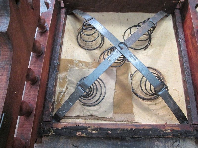

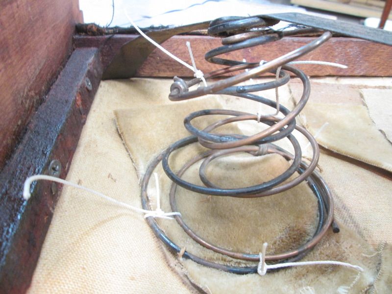

One of the springs on this rocker were soft.  I remembered years ago I bought these spring tensioners and thought here is a time to use them.  I could not figure out how these are installed or if they are even the right application for what I want to do.  I abandon that idea and cut another coil spring to fit and twisted it into the existing spring - which was part of a drop in unit.
I tied the springs together with button twine.

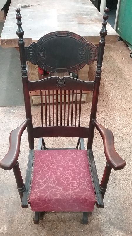

This rocker you're working on has a really weird seat design. It looks like maybe the last upholsterer screwed it up or the original design was not crafted with the upholsterer in mind. I think the biggest problem you are facing is there is not enough padding in the seat. Hard to say how to fix it without being there. I'm not sure it can be fixed without changing the design and adding more padding. Of course this will change it from a flat seat often seen in antique furniture, to a crowned seat seen in more modern and more comfortable furniture. It really all depends on what the customer wants.
I'm not sure I would even call this a drop in spring unit but more somebodies bad idea for spring support. The springs aren't even tied with twine but just tied to the cover. I would be half inclined to nix the whole spring system and start from scratch with webbing, six short springs, 8-way tied. And a minimum of 2' padding, either foam or cotton or if you want to stay to the period horse hair. These options will add a crown to the seat so must run it by the customer first.

This is how I re-enforced the one soft spring.  It's working good and up to the level and feel of the spring next to it.
Kody you are 100 % correct.  Although I believe the drop in unit is original it should have been changed to webbing and new coil springs.  It was double covered - I removed the red fabric and intend to recover over the black fabric I left intact.  I'm thinking some cotton in places to even out the plane - a sheet of synthetic horse hair sewn on - muslin, dacron, new fabric customer gave me, double welt on the edges to replace the nails that were cracking the wood.
