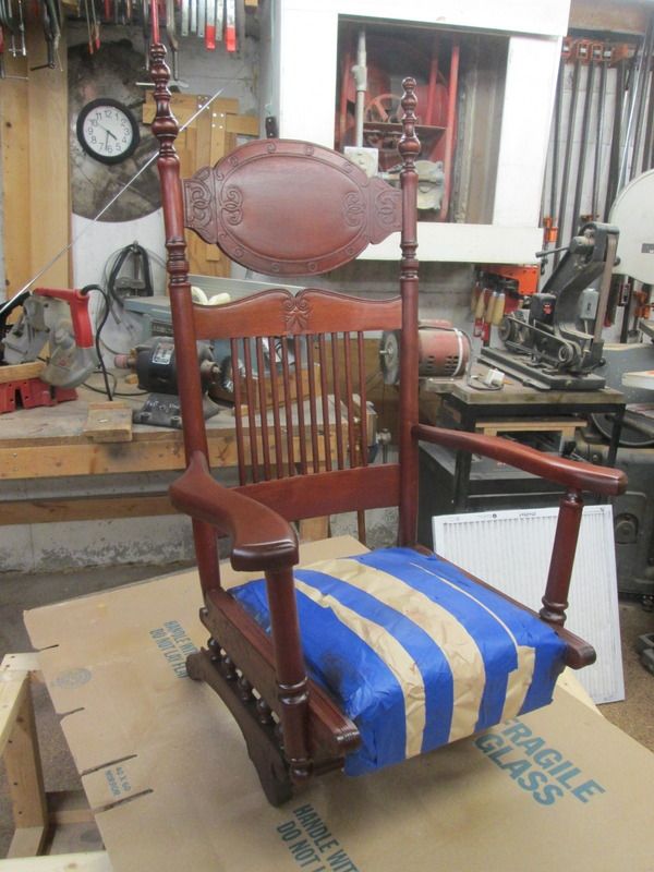

The metal on metal should squeak but when I pushed down I didn't hear anything.  There isn't much deflection.  Now that you mention it - I will put some cotton in between the coils and hope for the best
Wiping stain - 2 coats of sealer
1 sealer coat - 2 finish coats - gloss lacquer

The chair looks great Steve. The link worked good, was nanosecond fast.
I delivered the Rocker last week but I almost had to do the seat cover over.  While i was applying the gimp - I lifted the gimp to re-position it and on the way back down I rubbed glue against the fabric on the side of the chair.  This fabric called crypton was a vinyl with a backing. I couldn't pick  off the glue too well with the regulator and thought about softening the glue with the heat gun.  Thank goodness I did a test first on an extra scrap of the same fabric because the gun melted it.  Picking was nerve racking because the glue was stuck in the fibers of the fabric and I was afraid it would fray the surface.  I picked away - it didn't get much better and the glue was presenting a white course blemish on the pink fabric.  In the end i picked off what I could then lightly heated the glue with the heat gun - pressed it flat and colored it with pink lacquer touch up.  Don't laugh - it passed :)
