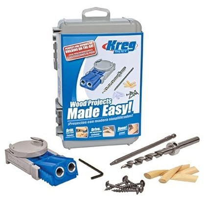

If you are getting into frame repair,  you should get a pocket screw jig.   Makes a reasonably strong joint or reinforces a failing joint without a lot of disassembly.  This is my favorite because you can use a screw to clamp it down to work and you don't need clearance to get a clamp  on it.
http://www.amazon.com/Kreg-R3-Pocket-Hole-System/dp/B000J43A7W/ref=sr_1_1?ie=UTF8&qid=1382753595&sr=8-1&keywords=r3+kreg+jig

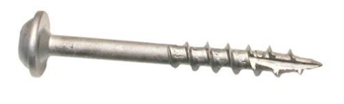

Add another $10 for a box each of 1.25" and 1.5" screws.   Don't use flat head screws or they split the wood.
So, it facilitates making a pocket for the screw, then you run a pilot hole through the pocket to accommodate the screw?
October 26, 2013, 01:17:57 pm #12 Last Edit: October 26, 2013, 01:21:20 pm by byhammerandhand

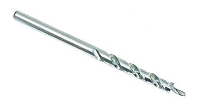

Nope. The drill bit is stepped and when set for the thickness of the wood the pilot hole for the shank of the screw goes almost to the end of the board and is centered in the thickness.  The screws they sell have an auger point so don't need a pilot hole in the matching piece.
You want to always do the drilling parallel to the grain, not cross-grain that would make a much weaker joint
If you look at the Amazon.com link above, the last picture is a video advertisement for its use.
DB - I bought the single hole Kreg MJK mini a few years ago after Mr. byhammer told me about it. I love it. It is amazing how easy it makes it.
I bought the single because I don't use it that often.
You can read the directions online and see how to line it up for different thicknesses of wood.
I use this jig for drawers, etc. Very strong joint and easy to put together.
I bought a different type that is made of aircraft aluminum and has a lever lock on it. It was one of my smartest purchases as I love the pocket screw setup.
