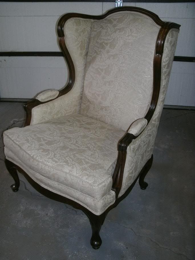

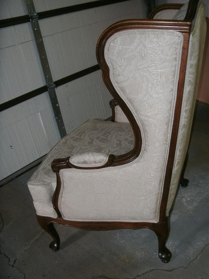

Finished these awhile ago and forgot to post the pics.
Thanks for everyone's input and a special thanks to sofadoc, can't dance that well so maybe I'll just share a beer with you
It became very easy to make the welt after a few practice runs with the double welt foot I purchased from Gregg. I simply attached it with a hot glue gun.
Not had the opportunity to reupholster furniture for a long time, and the customer was very pleased with the results and I was also.
As a side note I think that the manufacturer paid the employee that used the most staples to attach the material a bonus.
