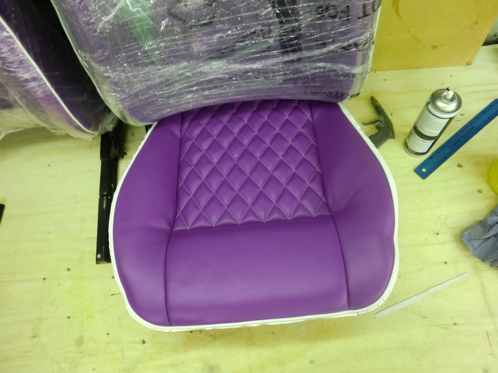

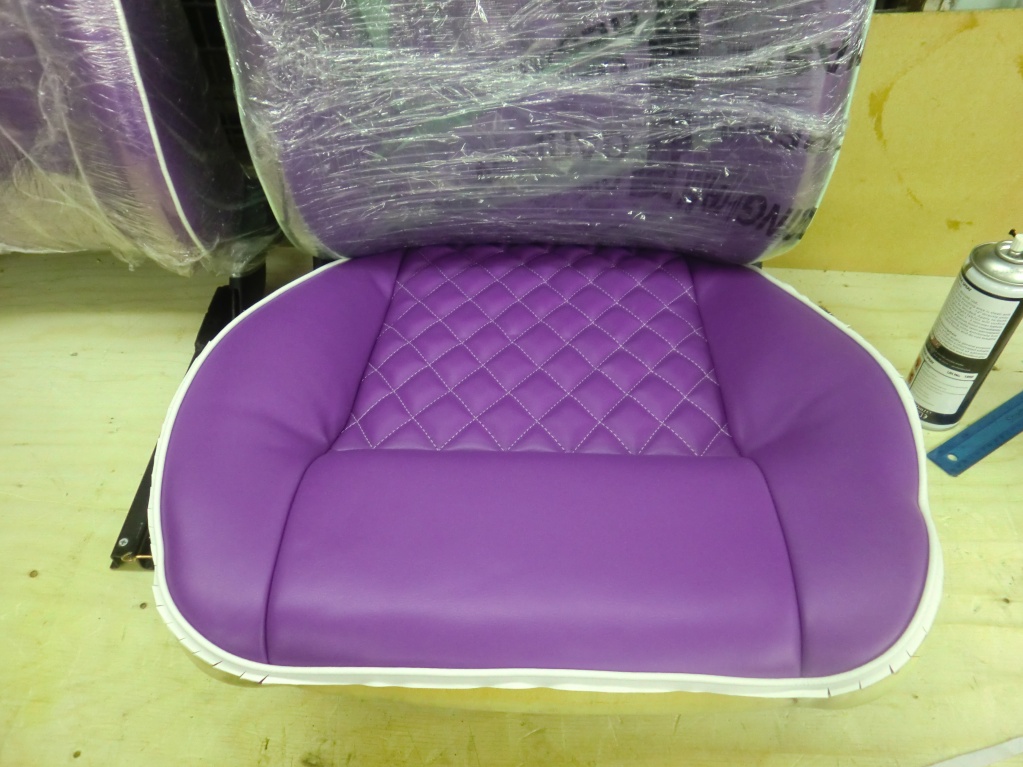

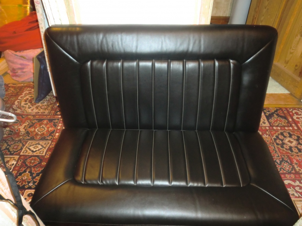

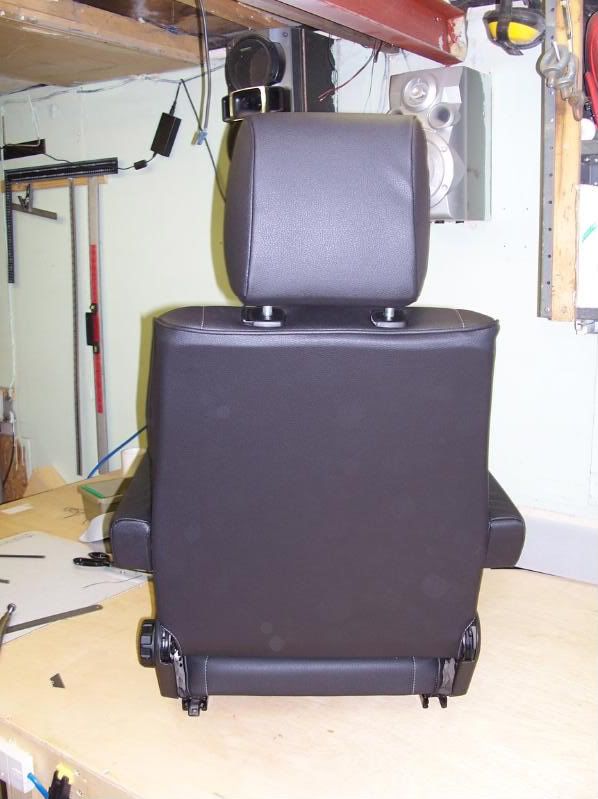

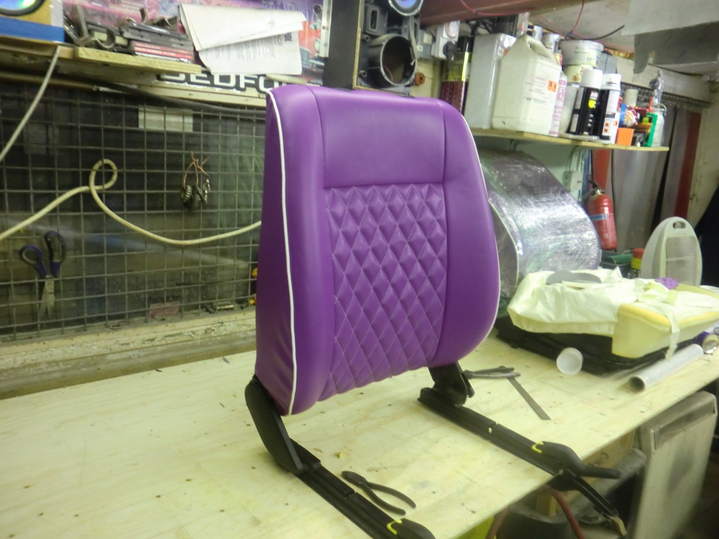

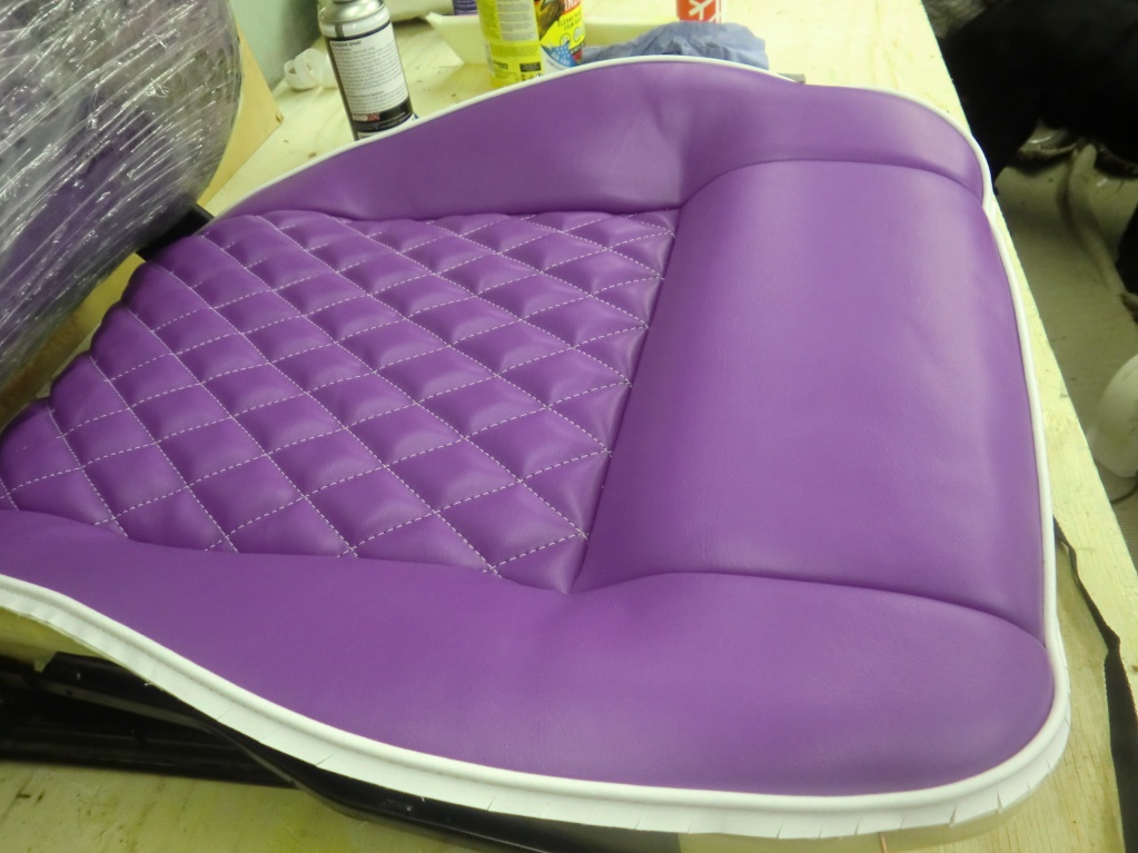

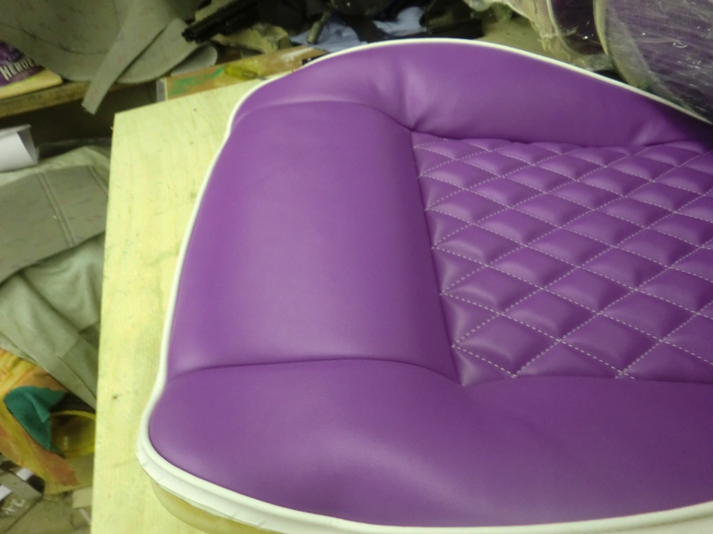

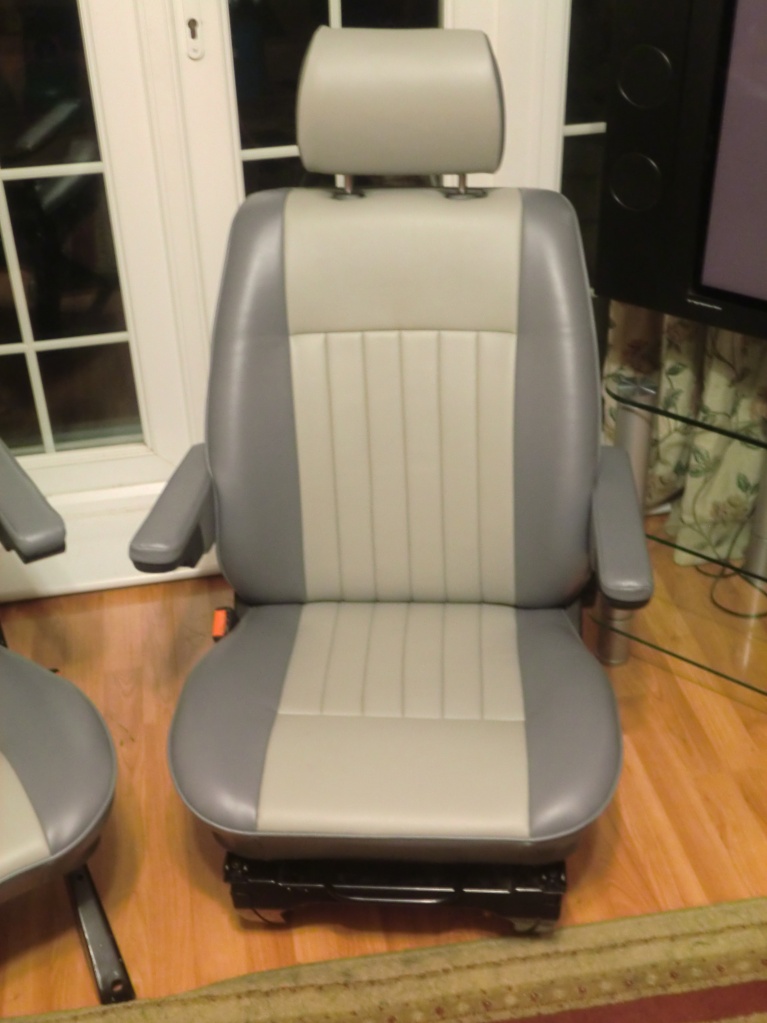

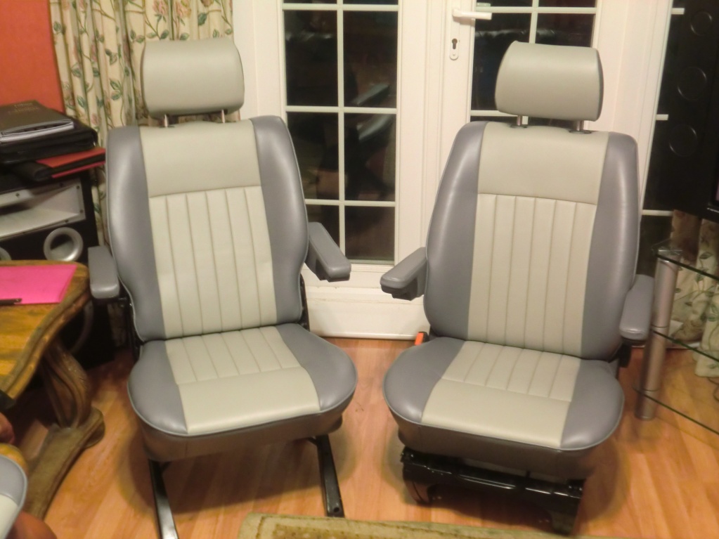

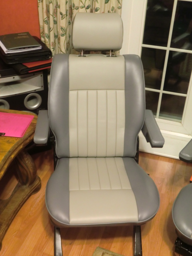

 some pics of the work ive done so far , doing it partime at the moment after work , the purple seats are the current projects

Indeed! Jazzy quilting! Love the purple!

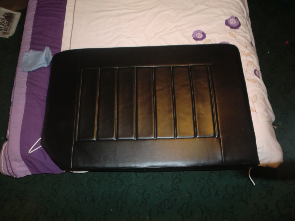

If you have a heat gun, try using it on the bottom of the black seats to remove the wrinkles.  I had some wrinkles on my first bench seat that I covered, and the heat gun did wonders for removing them.  Just don't get it too hot or you can melt the vinyl.  Try using it on a scrap piece first to see how much heat it will take.  Keep moving it back and forth while you rub them out with your hands.  Your hands will help you feel if you're getting it too hot.
The purple seats are really coming out good.  Be sure to post more pics as you finish.  Great job! ;D

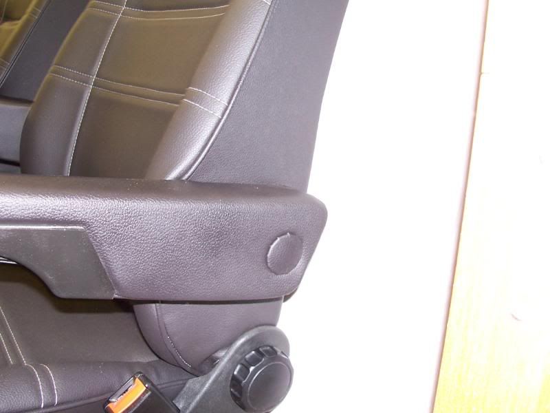

hi bobby , thanks for the comments , i have been using the heat gun on the wrinkles when ive smoothed the seats out for the customer to collect. the black wide cushion the guy wanted a old used effect on the seat so it didnt look too new in his van. . i will post more pics when i can figure out how to make them bigger , i use photobox and a hosting forum on rods n sods website. cheers ade

With the quality of work in the pictures you had posted, I figured you had probably already been using a heat gun. ;D  You're doing some excellent work for part time!

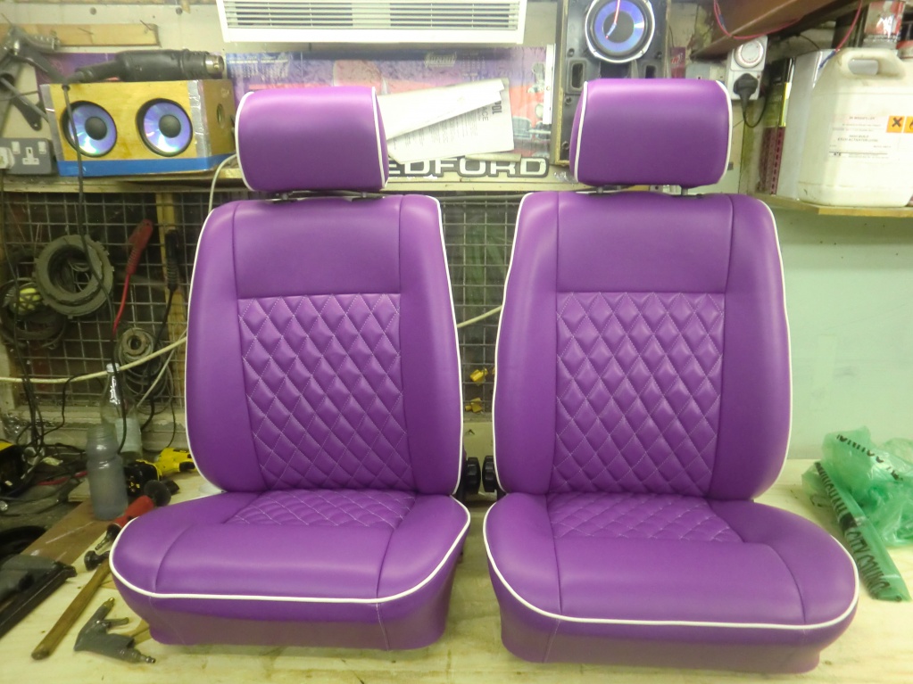

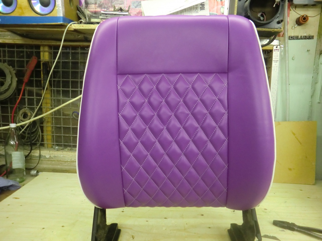

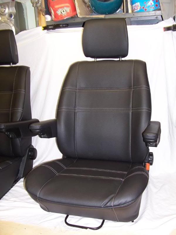

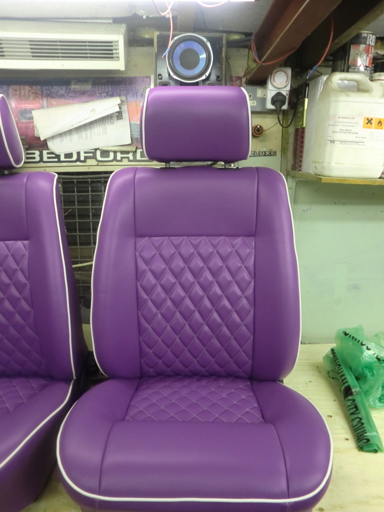

purple ones finished , done some in blue too ,
hdflame
I have a local shop that I stop by on occasion.  Your work already looks better than much of what I see that comes out of their shop, and they've been doing it for several years!
Like Loren said, you seem to be a natural!  Keep it up, and keep sharing your work.

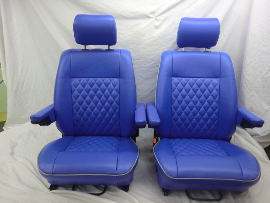

these are the latest ive just completed , theres two fronts and two rears , ive taken a pic of one front on the right and the rear on the left.

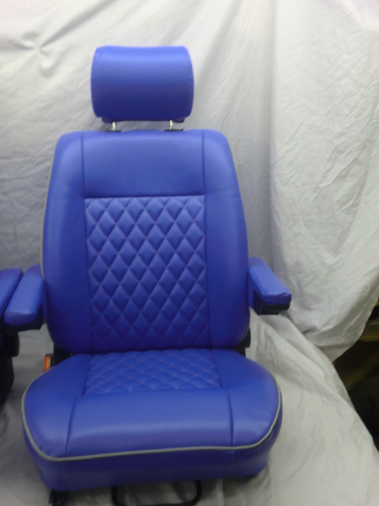

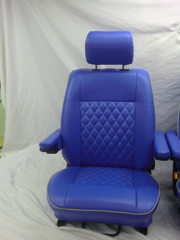

and these are the blue seats i did a few weeks back
ade
Really looks great! I'd be more than happy making any of those!
I hear what your saying with the heat gun. I used to view it as cheating, not sure why. Now I use it any time I'm feeling a little lazy. Same with thin plastic over the foam. A very helpfull tool to get everything tight and looking good. Heat guns won't make miracles happen, but they sure make it easier. I was sold on my steamer till it broke, now I only have  a heat gun. I liked the steamer more since it was less likely to melt the vinyl and it had the bonus of 'poofing' up the foam. But hey, even a hot ray of sunlight helps.
