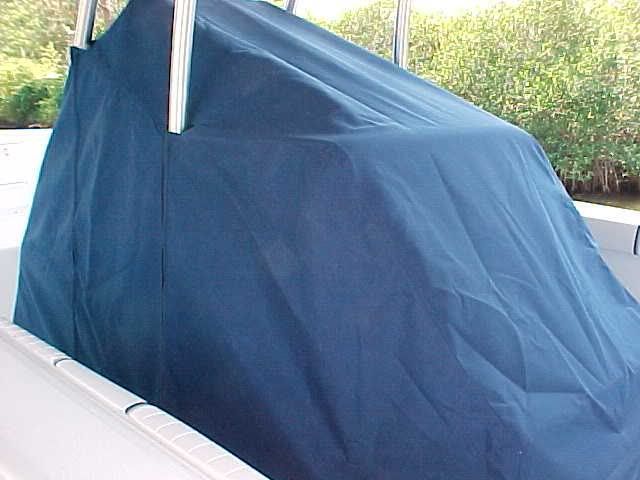

Here's my take. I just happen to have a picture.
1/2 a paper pattern.
And done.
We put a vertical zipper in between the bench and console for assess and storage.

Here is the final product, it was harder than just going back over the rear seat, but hey this is what he wanted.  The steering wheel and the throttle made the shape weird so I took in the top piece with some dart seams, then patterned each side.  The trick on this one was to sew one piece on then pattern the other side.  I was able to get a nicer fit I think.  The guy couldn't have been happier with the color match too.
