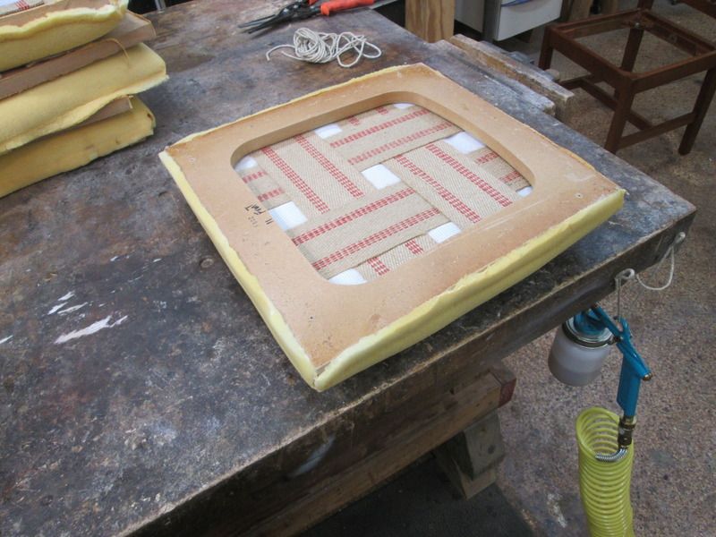

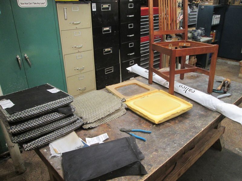

I got 6 seats to do - Stickley side chairs - cherry.  The no sag was mostly torn away and the owners are sitting in a hole.  The foam is good and I will use webbing, burlap, and cotton and put the existing foam back - it's in good shape and sculptured nicely to the seat.  Over the old seat foam was a 1/4 inch foam wrap that was glued to the seating foam and to the sides of the wood seat.  I don't think many here (experienced upholsters) would take the time to razor off the foam from the wood.  I'm guessing you would tear it off and replace it with new.  It took time but now it will be easier for me to put it back in the original footprint - everything is labeled.  The seats were very tight and although the new fabric is thinner I still need to mill down the edges 1/16 on four sides and touch the corners.

Sure - I could easily make 6 seats look like a sloppy fit.  When I picked up the seats I brought a screw gun - took the screws out and the slip seats wouldn't budge.  I punched it twice and cut my finger from the force - I had to ask the customer for a hammer.  Took 3 or 4 shots to push the seat out.  Although the joinery is mortise + tenon - pinned - and no danger of splitting apart  it just seemed way too tight.   I don't know what Stickley is doing lately.  Quality is very questionable.  These seat frames are that paper pulp and are slightly warped concave - might flip them over.
The fabric was stapled on w/3/8th staples and I was able to pull the fabric off with a light tug and every staple followed.  This customer likes Stickley - this is the same customer I did the Ziggers for last week on their Stickely L/R Chair.  Stickley furniture is world famous and it's odd to see the quality diminish.

The slip seat frames are MDF -
Customer never had them recovered.  The foam looks molded but it's from being held in place a long time from the first fabric.  In order to cover the vertical edges of the wood slip seat they wrapped a thin foam over everything instead of a dacron. Yes make a profit but the seat is not the place to cut corners.  No matter how the chair is built or looks it's the seat that needs to be comfortable and hold up.  Stickely suggest buy once and it lasts you a lifetime.  Or maybe 5 years ?

Webbing - the old no sag - and a layer of cotton; and glued the foam seat edges onto the wood sides.  I will put dacron (good advice) but keeping it away from the insert edge.  How come no one mentioned about working with spray glue and cotton:) - don't ask !

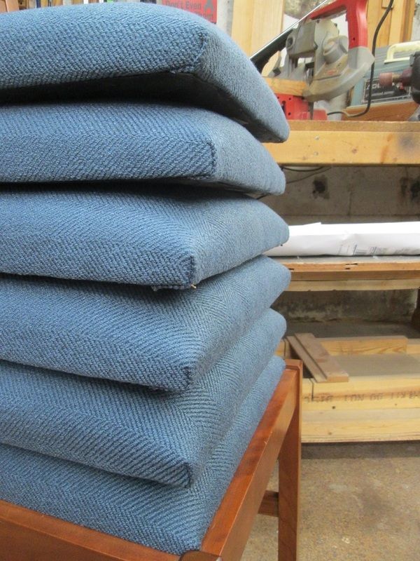

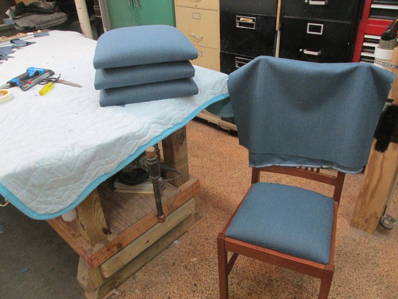

Have 4 done today - but now burned out.  The trapezoid shape combined with a faint stripe in this chevron pattern took a lot of time.  Front to back wasn't bad but that side stripe had to look the same as I pulled the fabric.  That drove me crazy.  I took out and put back quite a few staples for every seat until it looked right.  Raising my bench up 8 inches made a difference for less back pain while putting the finished fabric on

Lookin good there Steve. Sometimes the hardest part is figuring out how to do it right. I did two jobs that way today. But of course we don't include it into our estimates.

Yes I glued dacron over the top of the foam  seat not letting it extend down to the part that inserts into the chair rebate. The cotton I only used under the foam to give back some crown. For the bottom I will reuse the cambric I took off -

Looks good Steve. What did you do for those front corners?

You're right exercise is key and I've always done that.  What will serve me well is if i could loose some of this beer gut.  The doc tells me that my back is full of arthritis and when it wants to flare up there isn't much I could do to prevent it.   The corners are pleated and you can't see the pleat when looking down from the top
