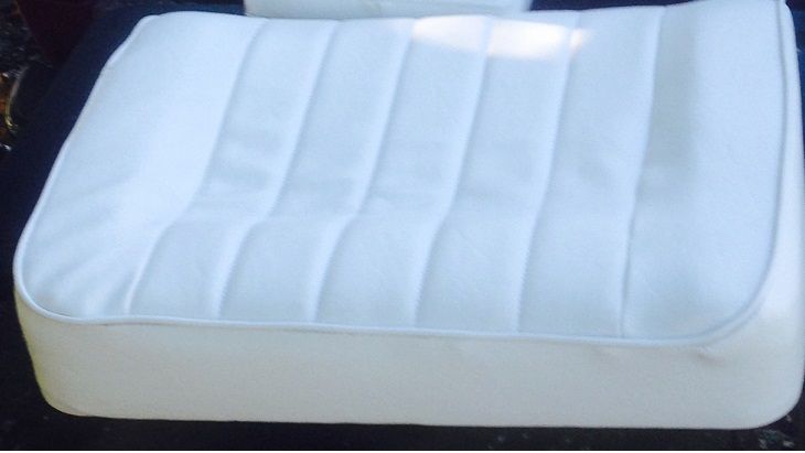

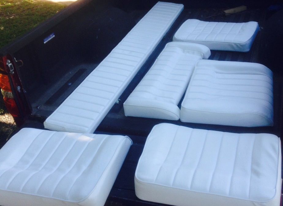

Just finished the rear seats and Deck Hatch Cover on a 22' Cobalt Boat  Next will be the Bow Cushions.  LOTS of Pleats!!!!

BlueFlamingo
32oz marine Vinyl with 1/2" Scrim Foam backing.  Using #92 Polyester Marine Thread.  Seat bases and backs were all water logged and rotted.  Had to remake them as well.  Used my wood sealer formula of 1 Part Boiled Linseed Oil, 2 Parts Mineral Spirits and One Part Spar Varnish.  Saturated the plywood edges and then coated everything with 3 full coats of the spar varnish.   They won't rot again.
