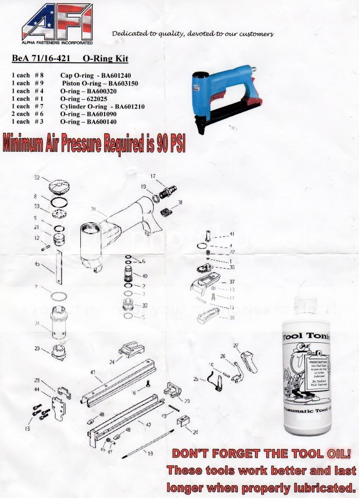

I also bought my last BEA gun over 10 years and paid more than the one in your link. My current gun skips staples. The plunger doesn't fully retract and will not let the next staple engage. I think its the O-ring on the plunger and could be fixed with a rebuild kit but sometimes its easier to just buy new.
There are rebuild kits for the BEA, my vendor said.  I believe he said they will do the work.  Mine has been going for a good while and hasn't needed a rebuild after several years but good to know the repair parts are available.
Thanks Doyle. Now you got me thinking I should go with the rebuild kit.  :)
Ed:
These guns are very easy to work on. Give the rebuild a try. I believe one of our vendors on here sells rebuild kits. Andrew maybe ??
My BEA is 8 years old. I bought a rebuild kit a few years ago and it worked great. $15 I think.

Here's a breakdown of parts for the BEA in Andrew's catalog:
http://www.pageturnpro.com/Progress-Printing/26266-DLT-Supply-Catalog/index.html#/172

30 years ago, paying $100 for a stapler was a major investment for an upholsterer. It would last 10 years before needing any parts. My wholesale supplier would rebuild them for around $25, and they would last another 10 years. So rebuilding them was the way to go.
But now, guns are still in the $100 range (and below), and since there are so many brands, o-rings and other parts can be hard to find. And since there doesn't seem to be as much disparity between $25-$100 anymore, most people just trash them and buy new.

We are one of BeA's oldest distributors... 60 years or so.  We recondition them all the time.  Often, it's not more than $20 parts and labor.  Typically the only parts that go on them are the o-rings and the occasional plunger.  We have customers that have been using them for 30+ years and they still function like they're brand new.
-Andrew
