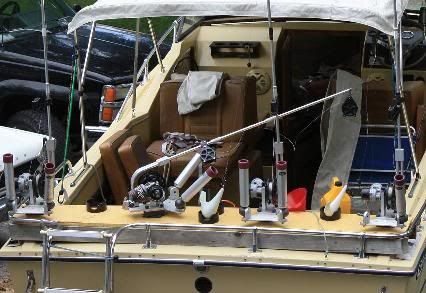

Here's the problem I am having with the aft end...hope this picture comes out OK.  He wants me to put studs on the deck in front of this boardfull of fishing junk.  I don't want to, but I don't see any way to get it over/around all those obstacles on the transom to use the snaps on the back.  Ideas would be most welcome!!!

I think he should take all that stuff off the back.  Isn't there a point where you just can't put canvas on it, or am I showing my "noob"-ness?

I fish. All that stuff on the back of his boat is a Charlie Foxtrot. Looks like a cold weather lake fisher to me.
Snaps prolly wont hold. At a minimum you would need turn fasteners. However, they could be hazardous depending on the mount location. Is it possible to mount the fasteners under the board? So, is the board permanently attached?
Attach webbing to the bottom side of the board and use D-Rings on the curtains?

He's got over 4k of bigjon ecric downriggers there they sreeasily removable most people
take the
off when not using and store them inside
You could install a awning rail with a zipper maybe to make it easy if be I insists
I'm with Mike and Jsquail on the fishing gear.  I'm quite surprised he'd want that area exposed.  That's expensive stuff to leave out in the weather.  And snaps will definitely not hold on the front of that board.
If it were my own boat, what I'd try to do is build a cover that is elevated across the transom to cover the gear.  I can't tell from the pic how high it would need to be - maybe 18 inches?  You'd still get water runoff with the angle from the back edge of the bimini.  I'd put is some short tent poles that sat on the ends of the transom (they can be cut to any length easily with a hack saw).
You'd need snap studs on the ends of the poles and snap sockets in the canvas.  They do sell tent poles with snaps in case you've never seen them.  You could then fasten the canvas to the transom behind the gear with with either snaps or turnbuckles.  Risky project - my idea might not work at all if the canvas flaps and the base of the poles become unseated ... unless you somehow create a socket on the board.  Maybe a railing stanchion to hold the pole securely at the base?
