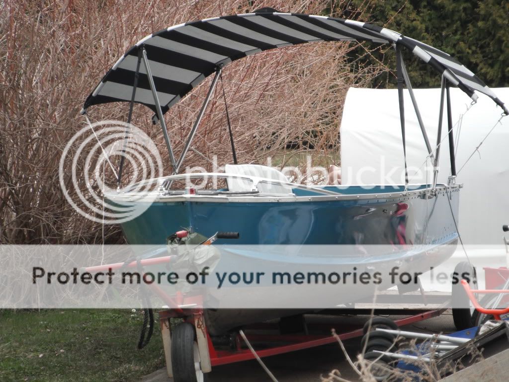

I just pulled it out of the shed today (probably a month premature) and thought I'd show it off a bit. I was originally designing this to be the tent part of a bicycle tent trailer. The batons were to unzip and form the body of the trailer. Didn't get that far. Got stuck on the bimini part.
This was the 'proof of concept'. I made it with tent poles instead of batons. I had probably thought about this for more than a year so it was nice to see it worked. So then instead of designing a trailer under it I bought a boat.
This illustrated the only real advantage to this style vs regular tube framework; this bimini works in many configurations on many different beam boats.

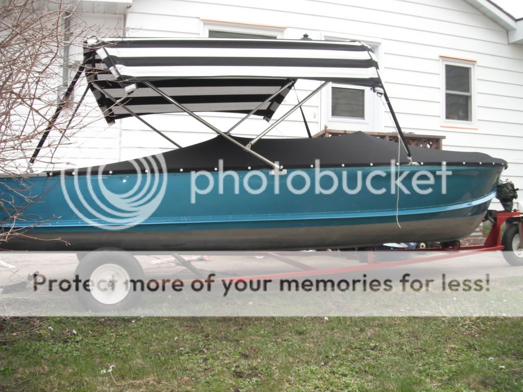

So here was the finished bimini and boat.
Here's how it works-

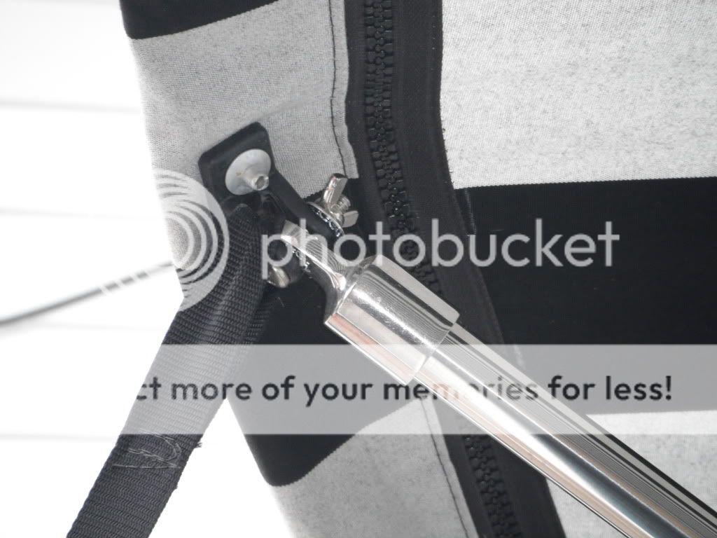

here is a baton (1 1/2" x 8') wraped in sunbrella with a zipper sewn in with 2 deck mounts riveted to it.
straps come from the deck mount and from the tip of the bimini from a D ring.
A flat piece of cloth with with zippers form the body of the bimini. This zips to the batons, the shape of the zippered ends creates the structure.

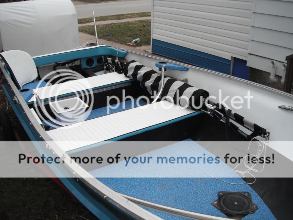

The other advantage to this system. It folds into a line. No big U.
here it is stowed.
Here's a close up of the deckmount attached to the baton.

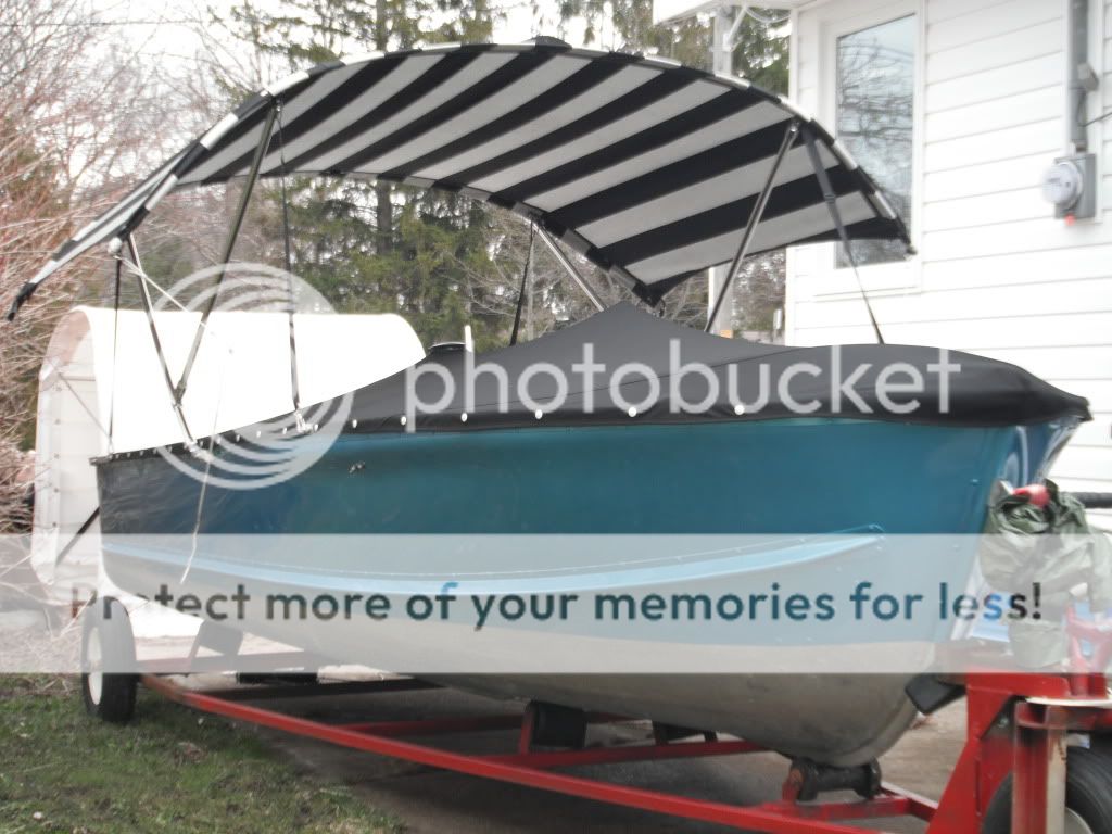

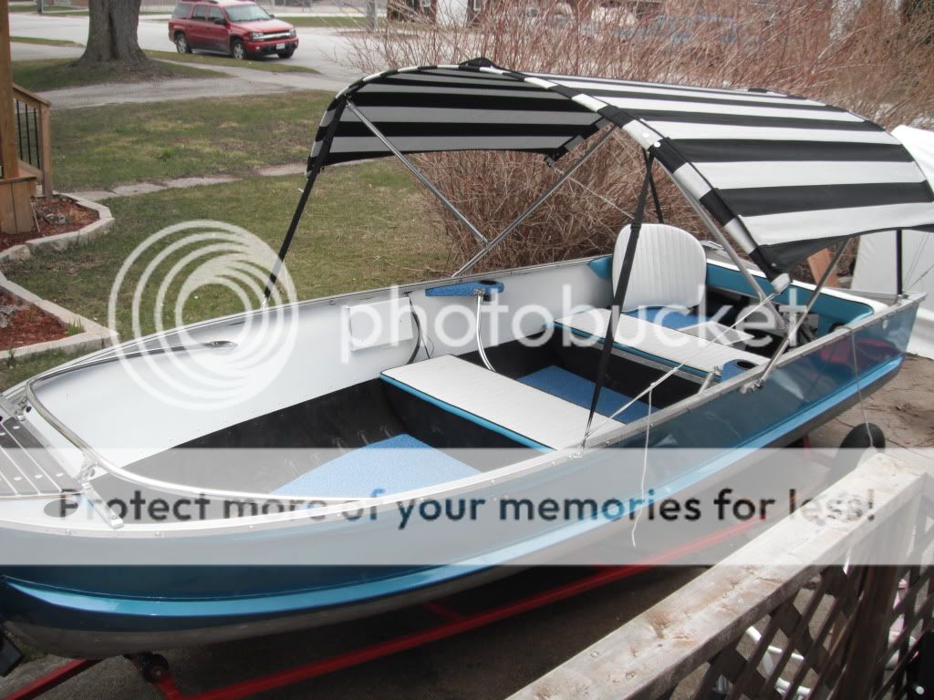

Side view. The black straps pull the bimini front to back like a normal tube bimini. The white rope make it curve and give it diagonal strength. In winds it does get pushed around but these white ropes gove it 'spring' and so it fights back a little against the wind.
But really, all this talk about why this rig is any good is just to justify all the time I've spent thinking about this to my self. And the real reason I built it is that no one else has one. And it's got stripes.
Here's some more views.
Thanks for letting me show off. (like you had a choice!) Any questions? I'd like to know what you think!
