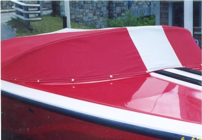

Rich if I'm making a cockpit cover on a boat with a curved screen / windshield I don't put darts on the glass area you can I'm I'm not waiting it wrong.  What I do is have a seam along the entire. Length of the top of the window frame so you've got 2 planes of canvas
http://i782.photobucket.com/albums/yy102/Mike8560/covers/Copy3ofmoomba_cockpit.jpg
Looks nice Mike. Funny , a friend has the same boat as mine 2 years newer. His factory canvas was done like mikes w/ seam along the windshield curve. Mine had darts on the windshield. Lots of ways to skin a cat !!!! I like Mikes way. I blanket , have patterned but prefer if I can just blanket it. After that its just binding and fastners.
