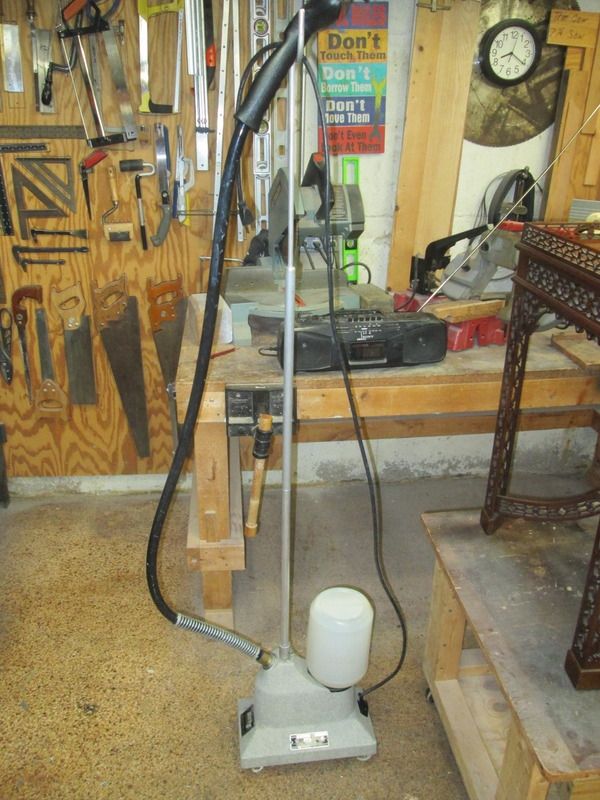

I was out on a service call and saw a steamer at the curb.  Took it back to the shop - the switch was broken but other wise looked fine.  I considered bypassing the switch but than gave Jiffy a quick call and a new switch was $ 10.00 - I ordered it - 3 days later installed it and I had steam in 3 minutes.  This machine works great.  My previous steamer was a tag sale purchase - high heat and high pressure nozzle.   I cleaned up the crystals formed by hard water and than it worked great.  The first job I used it on was a disaster - the customer bought a new sofa and submitted a complaint that one cushion was wrinkled.  The store said if I couldn't steam the wrinkles out they will replace the casing.  I fired up the steamer - put the wide nozzle on that had 4 ports and 1 minute later the to of the cushion had 4 tracks melted into the fabric.  Felt like a dummy but thank goodness a casing was available.  This Jiffy steamer isn't for removing the grease around your rims like the other one was  :) Nice new toy for $ 10.00. Old switch pictured

As you now know, the inner workings of a Jiffy steamer are pretty simple, and most of the replacement parts are cheap (switch, fusible link, thermostat). Only the heating element is pricey.
You may have got all the crystal sediment from the reservoir. But it wouldn't hurt to run some cleaner through the heating element. Jiffy sells it.

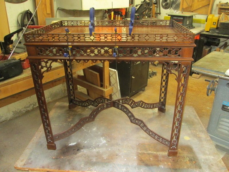

Kody the table  had some broken lattice work - 20th century - mahogany - the pieces all fit back so well there will be very little touch up to do.
