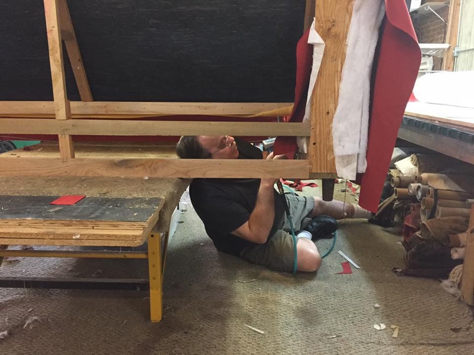

Quote from: kodydog on July 15, 2017, 05:56:14 pm
Sleepers are usually fairly easy. The hardest part is getting the sleeper back in without ruining the fabric.
Since I seldom have help, I don't remove the sleeper mechanism. You can't tell by this pic, but the sleeper mech is not removed, but just extended out. I turn the frame sideways to straddle the table so I can crawl up under and staple the new cover around the mech.
The most important thing to remember, is to make sure that your stapler is full before you crawl up under.
