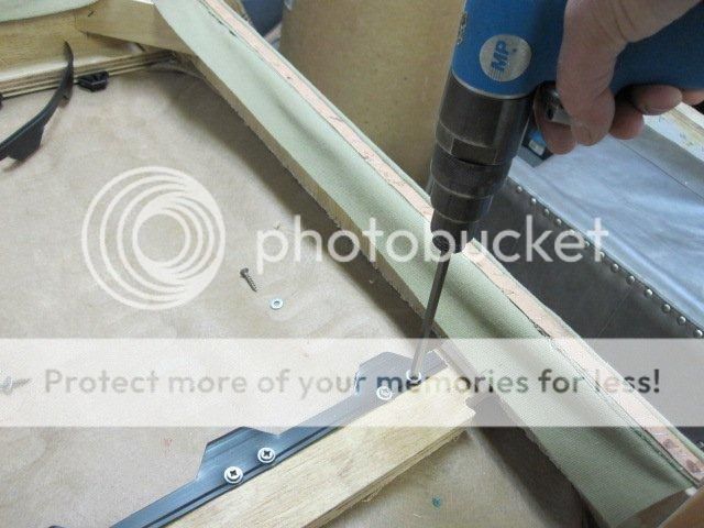

Well, I heard back and got sent a process from the manufacturer.   Don't know why they didn't send this with their original RFQ.   Here's what it looks like and they just want the strip attached with screws to the bottom of the rails and have it a bit lower than original.  (see the original at the top of the photo.  Also note the flaky Chinese plywood frame material).   The service company said they are getting a lot of failures and they're warranted for 5 years.  Sounds about like the average life of a sofa, huh?
I guess they want you to attach from the bottom to save labor time?
This goes back to what I said earlier. The clips need only be as good as the frame they're attaching to. Might as well be plastic. Metal clips would probably be overkill.
