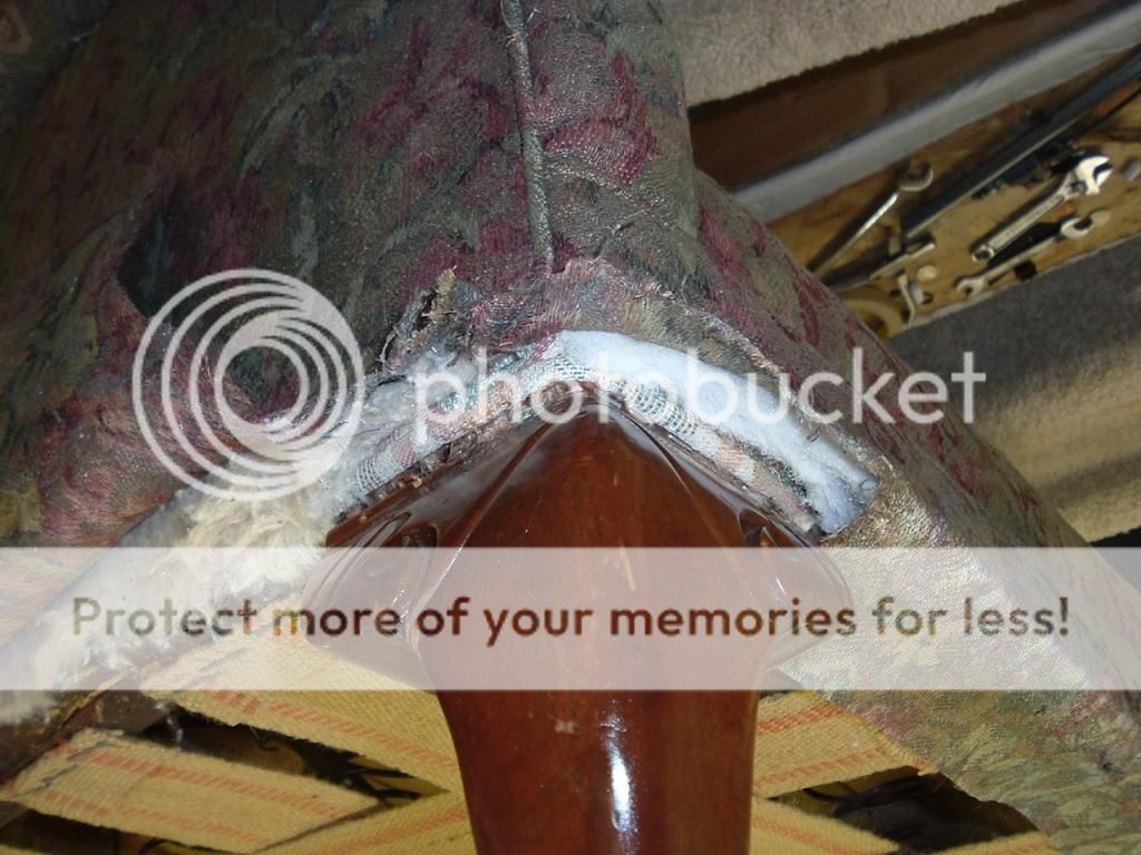

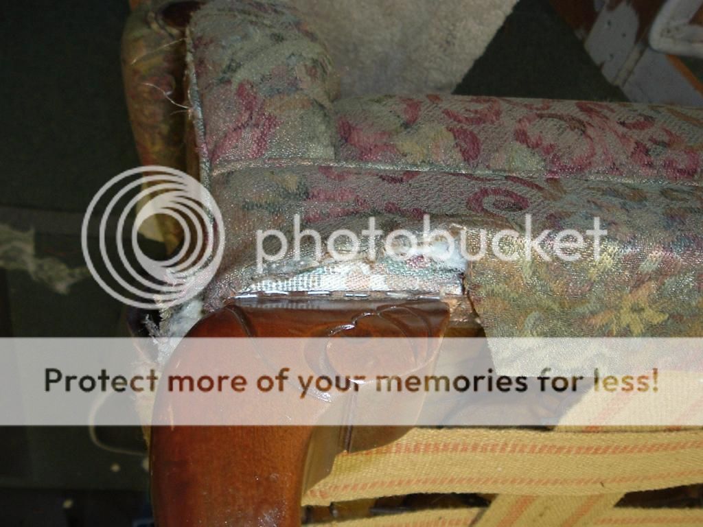

I haven't seen this technique before.
When we run welt cord around the bottom of a chair it can get touchy around the top of the legs, espeically if there is no groove for the lip of the welt cord to fit into.
There are several techniques that I use to handle this issue. Here's a new one for me. Old welt cord was stapled along the top of the legs. The face fabric was brought down over this welt cord and stapled under it. Then trimmed as close as possible.
The new welt cord had the lip cut off as much as possible, and then run under the lump (old welt cord that had been stapled first), on top of the face fabric. It looked great. I didn't notice it until I tool off the old fabric.
I hope these pics show the technique well.
http://i830.photobucket.com/albums/zz228/genejoe/th_DSCF3218_zpse9803769.jpg
http://i830.photobucket.com/albums/zz228/genejoe/th_DSCF3219_zpsdbeae939.jpg
We use some cardboard taking strip to build it up like that. 2 or 3 thicknesses does the trick.
