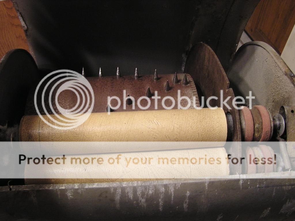

Here is what I use ... handed down from my mentor :-)
Other than the cardboard attachment thingy my hubby made for directing the fluff into an attached bag it is all original ... here is an image of the working components inside the unit

Thanks Lo.  Your machine looks like a beefed up wool drum carder.  I thought about borrowing one, but I am afraid the feathers will clog the machine.  The pins are quite close and the machines are upwards of 400.00.
