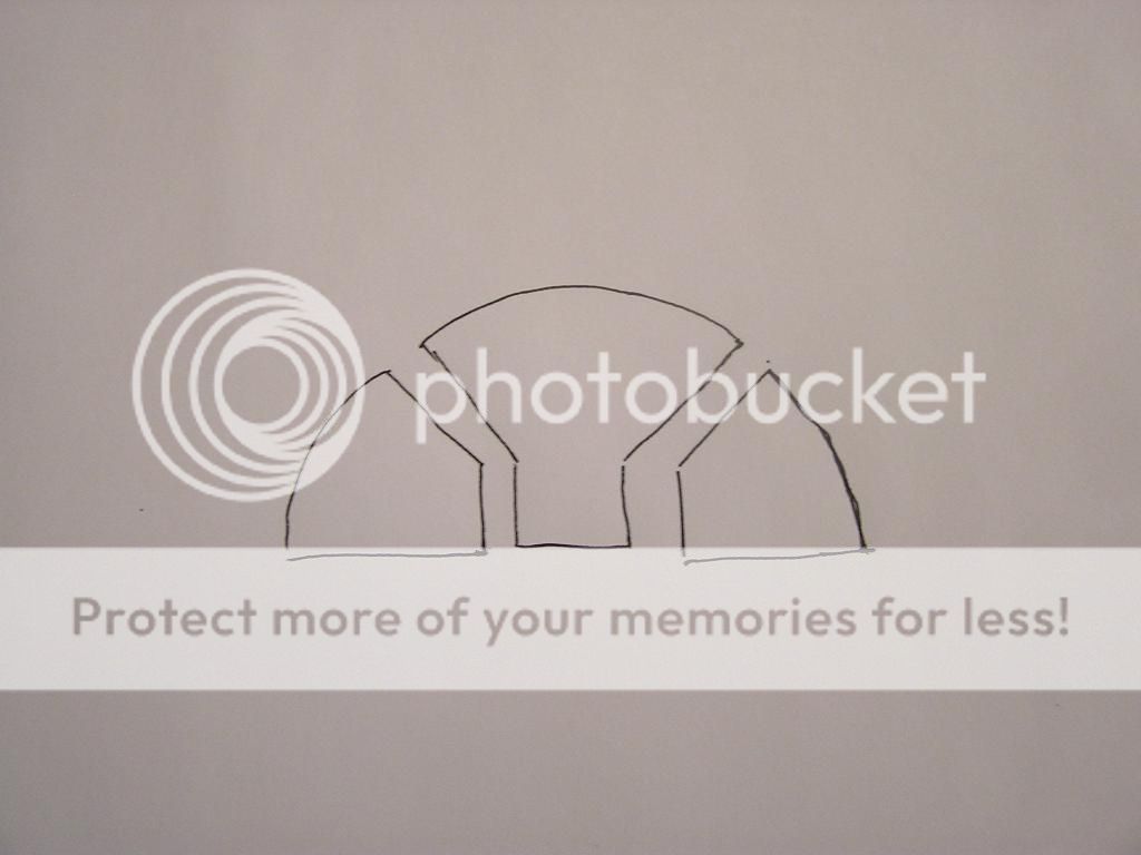

The back has a strong curve ... similar to corner booth seats (the 'U' shaped ones). The center pattern for the 'U' shaped seat reminded me of a baseball diamond ... seemed like such an odd shape but fit seamlessly when blended with the right and left. Maybe someone has patterns that could be modified for yours? I do not believe I saved any from restaurant work this spring ... now watch, I'll come across a set  ;)

November 02, 2013, 04:49:19 am #8 Last Edit: November 02, 2013, 04:50:20 am by Lo
Not sure if this will help as your vertical seams may already have this pattern shape ... if not I am attempting a first picture post and have drawn out the shapes I mentioned in my earlier post.
Very rough sketch so no finger-wagging at my 2nd grade pic :-)

Lo's diagram really "illustrates" how strange looking the shapes can be when you're trying to come up with something that has to fit around curves!
