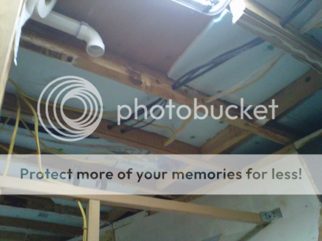

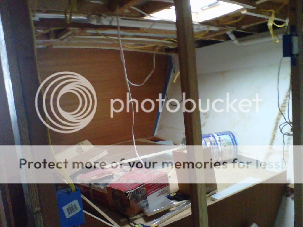

Ok starting a big job, complete sewout of a 52' sportfisherman. The first step is to tear out the work started by the owner. He was glueing up thin foam and vinyl. Not going there again. His work has the typical hand prints and dents. My experience is slim in this area except for the nightmare last summer of a glue up that took too long and caused too many gray hairs. I've been given freehand on what to use. Right now the boat has no finishes. Like a house before drywall. In the salon there's bare ply. Below there are framing members. What system would you recommend for ease of installation and finished look? There's a LOT of work in this boat. Don't want to get hung up on the 1st step which is headliner. Thanks in advance.

oh well at least I got a link that worked, heres the work the owner started
<a href="http://s382.beta.photobucket.com/user/forsailbyowner/media/waverider3.jpg.html"; target="_blank"><img src="http://i382.photobucket.com/albums/oo269/forsailbyowner/waverider3.jpg"; border="0" alt=" photo waverider3.jpg"/></a>
