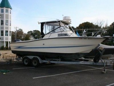

Most of the boat covers I've made have been cockpit covers or snap on full covers for smaller boats. This is the boat I'm making a full cover for next week (minus the enclosure):
Would you go over the rail in the front, or make cutouts for the bars? Also how far down would you bring the cover - it will have grommets for the tie downs.

It's a 1987 Hydrasport walk around 22'.
I'd go over the railings and down about 8 to 10 inches below the rubrail, maybe lower in the bow.  With the undercut of the bow, a fitted nose will make it much less likely to blow off when trailering (I assume they want to trailer it).  If it's just for storage, then maybe 8 inches all the way around.
As june id go over the rail and form fit to the hull to make it snug iver the. Ow id go over the rubrail about 10"
Also with a strap around the perimiter and strap downtot he trailer ot lift. Every 4 or 5' along the sides.

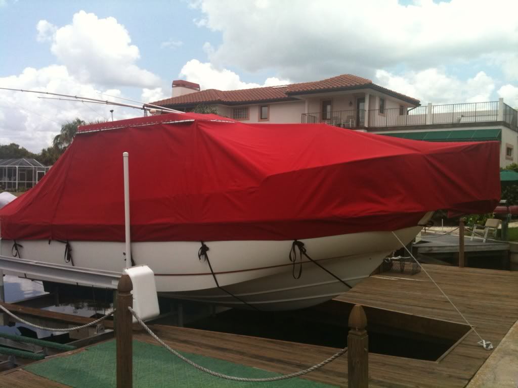

Here is a 30 grady i did a couple years ago

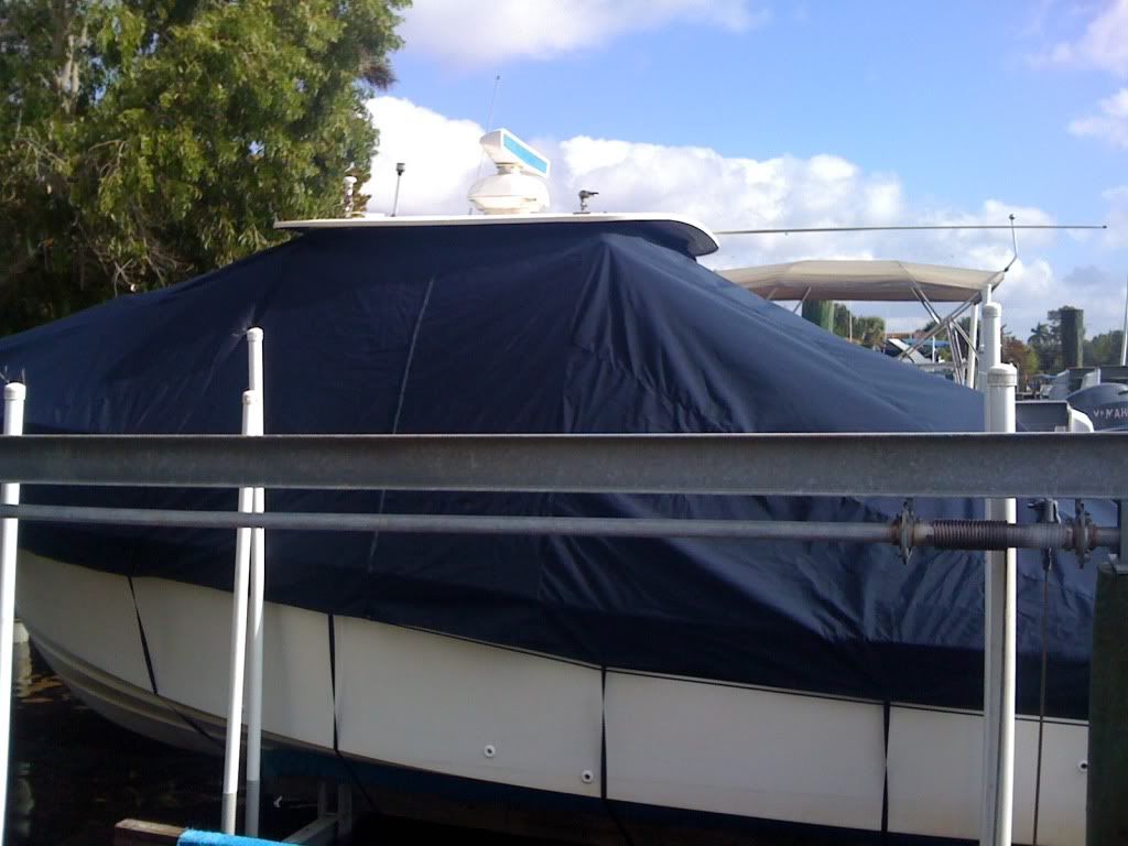

This was a whaler center console but very simmilar
Bolth top
Suspended from the hard top also ihave a zipper on each side and break the. Over into 2 pieces to getaround the top or t top
Thanks guys! Can I ask, how do you treat the bottom perimeter...how are the straps attached?
At the bottom i have a pocket with a stap arounf te perimeter eith a buckle to tighten snd buckle at the zippers.
For the strap mine shown go under the bost sns strap to the other side.  Each strap is started eith a reinforcement mar of heavy fabric kike her ulite to stread the pull of the strap with a buckle on the otherside. I sew the long strap on the canal waterside  of the boat then hanging down thebstrap csn be hooked underneath with a boat hook pull under to the dockside  and secured.
