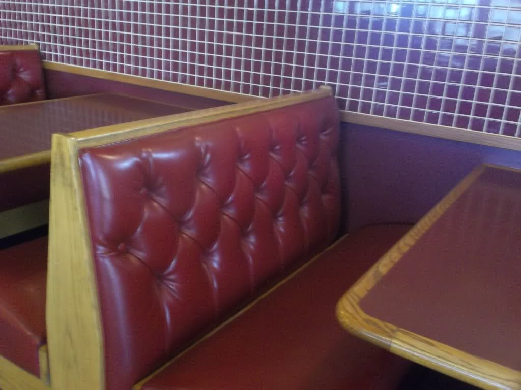

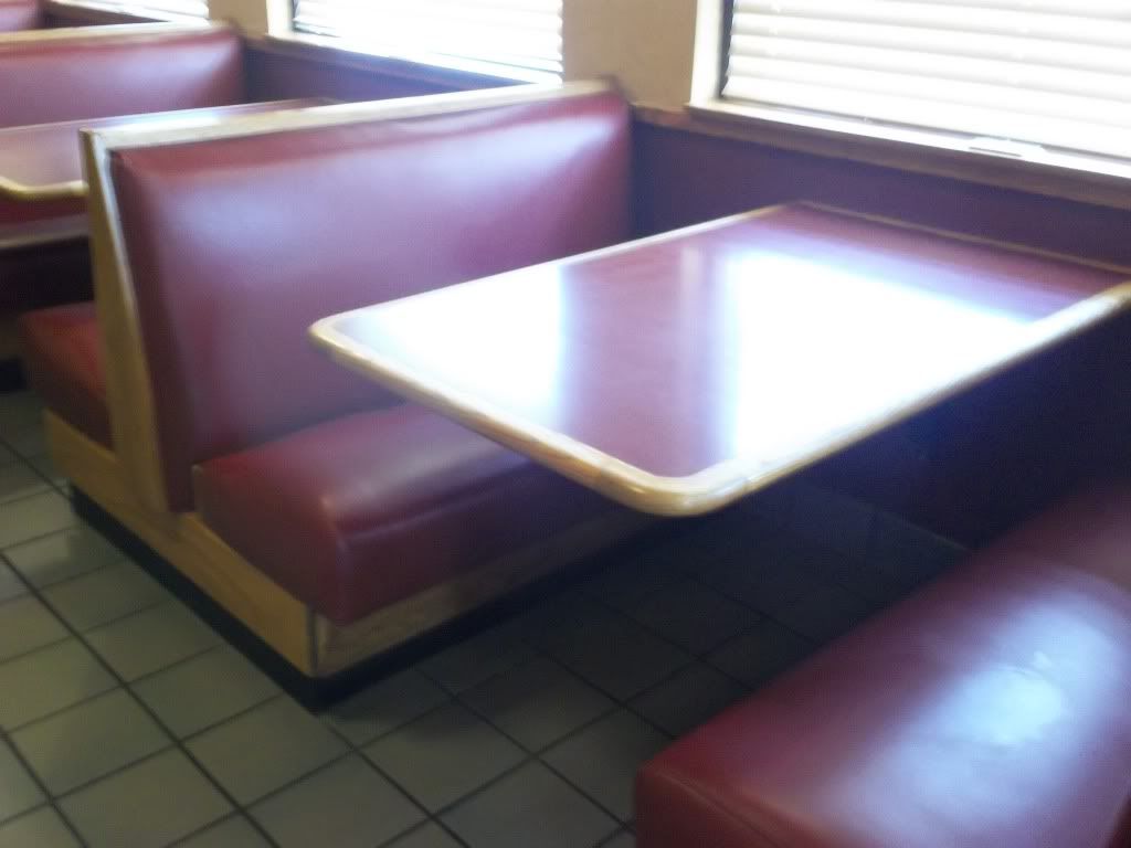

Me again.  I called a guy about renting a space to work, and ended up looking at 16 restaurant booths to upholster! (I really don't know how this happens.)  :o  There are 8 seats, 7 backs, and one curved seat.  He wants the button tufted seats backs to be changed to match the solid ones.
tufted booth to...
smooth back...
I can do the math for the bid, but since I have not done this before, I do not know how long it "should" take me. So if someone with experience, could let me know how long it would take you, I would appreciate it.  I am still learning here, and I don't want to charge my customer for my education.  Also, there are two others bidding for this job.
I hope I did the photos correctly.  Thank you.  Carol

Hi cthomps. My first advice is don't let the restaurant owner influence your estimate by telling you he is getting other bids. They all say this. And do you really want to be the lowest bidder in town?
Are you replacing the foam or just filling the tuft holes with padding. If its the latter I would also add a layer of Dacron.
I would charge one hour for each seat and one hour for each back. No it won't take you this long to do each piece but will help pay for all the extra charges we conveniently forget to add. If you charge $40 an hour it is still a good deal for the restaurant owner.

Would you fill the tuft holes, or replace the foam?  The restaurant was built in the early 90's  and I think the tufted booths are original.  I guess I could bid it both ways and let the owner decide.  Your thoughts?

Quote from: cthomps on June 07, 2012, 05:34:40 pm
Totally up to the owner. My guess is they will want to save money. Your idea is a good one.
Personally, I'd rather replace the foam than spend a lot of time filling in the holes.
Also, I try to arrange doing the backs onsite after hours. I'd rather stay up late (or come in really early) than haul them back and forth to the shop 1 or 2 at a time.
I pre-sew all the fitted seat covers at the shop,  pick up the seats at closing (as many as I can do before they get busy the next day) and bring them back the next morning.
Sure, it's a pain working the "graveyard shift" for 4 or 5 nights, but I'd rather do that than make umpteen trips during the day (especially when someone is always sitting in the very booth that you want to pick up.

I would cut new foam. I'd tell the customer that the labour to fill the holes would be close to a new sheet of foam, but he be throwing good money after bad using the old stuff.

I'm looking at the photos and thinking this is not a high class joint where the owner has bottomless pockets.
If this were somebody's home I would defiantly say, yes replace the foam. But we all have dealt with restaurant owners before and know they usually deal with the bottom line.
I'm thinking stuffing the holes with cotton and covering the foam with a layer of Dacron will be more cost effective. Opposed to replacing with a $30 sheet of foam. And in my opinion will take more labor as well.
I'm open to comments.
