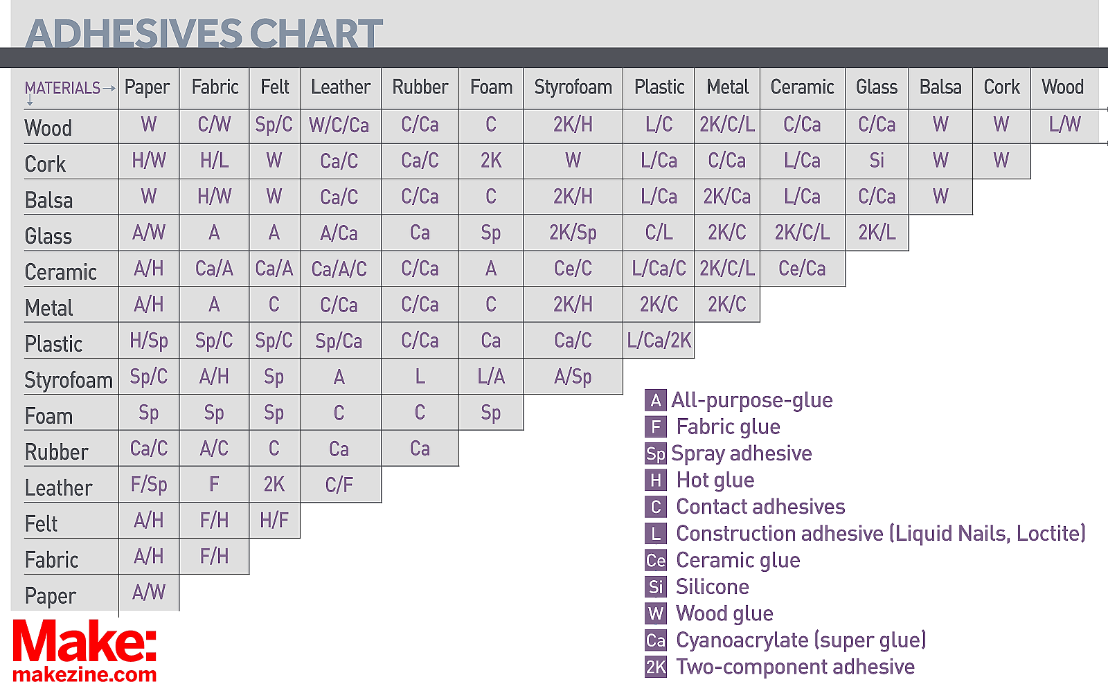

Found this glue guide, in one chart.
Also helpful is http://www.thistothat.com/

Your chart might be helpful but it doesn't get any bigger.

Hmm, when I (right) click on the chart and select "View Image", it gets full screen???
