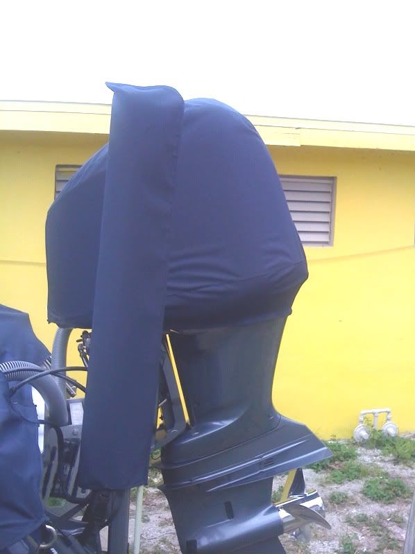

i make my covers form fittted snug no flapping in the wind and have never had a complaint even covers on my motors.
dose mimi not have the trio?
 :o Holy cow Mike,how do you get them that tight with spending ages on darts and pleats etc...,and how do you secure the "hem" at the bottom?
I've always just "blanket" patterned everything including these. PITA
Darren I have a seam at every line on the motor that seperates flat planes of canvas.
that was a newer style Yamaha 2009 it had 2 sections making the top to get that curved top a largwe side piece that wrapped around a a lower wrap aroud piece that was c shaped when cut out on the tablel and a zipper center front that closes the cover tight with the anbla bottom section it cant came up until the zipper is opened kinda like a pair of leather driving glove and stick patterning plastic to the top section marking the seam lines then add tape and stick the next piece mark the seams on it thought the clear plastic
( this is where I think paper would be a negative)
to pattern I start with blue painters tape at the the seam line then used 2 sided transfer tape s
March 19, 2014, 03:21:52 pm #6 Last Edit: March 19, 2014, 03:49:29 pm by Darren Henry
thanks Mike. I'll have to try that the next time I get one in.I've got some scratched 20 gauge and some cut offs.
I think the the difference between "blanket" patterning and your method is the sharp seam line. I too have seams at each change of plane---but no precise "seam line" on those bubble shaped motors like Yammies and Hondas. Then too the pieces of fabric might slip a titch, and you have no way to make alignment marks.
