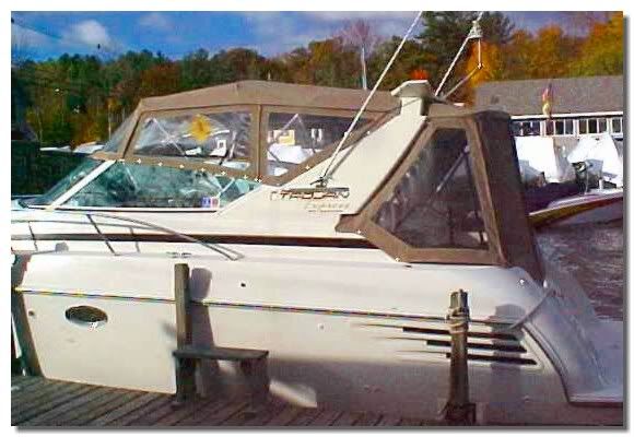

At arch reminded me of a Trojan I did about probly 10 years ago now  why is the sunseekers prone. To be leaky?
http://i782.photobucket.com/albums/yy102/Mike8560/Express%20cruiser%20enclosures/trojan36b.jpg
