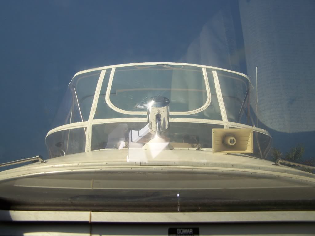

Have You tried 60g stRataglass Howard ?
Mon my bay I used 40g but on the two front  corners I used 60g
http://i782.photobucket.com/albums/yy102/Mike8560/BLue%20Dolphin%201/100_1866.jpg
