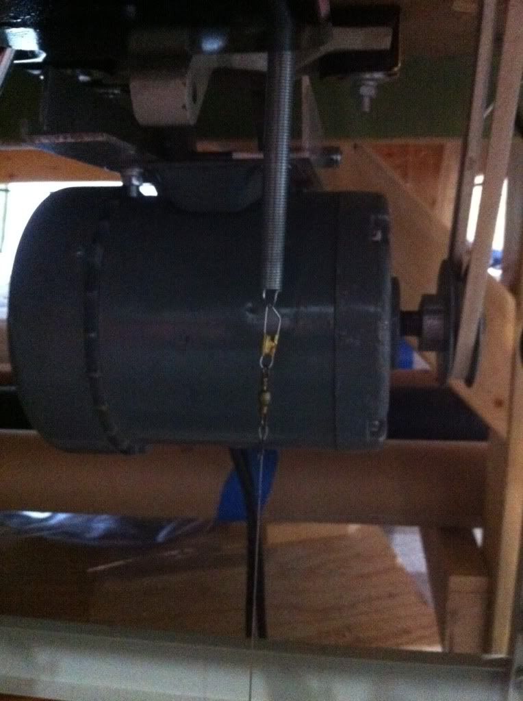

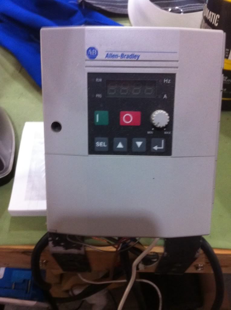

When i was younger I worked in an automation control shop. went and looked at my setup again. its a 1/2 hp, my original clutched motor was 3/4. The 1/2 hp is slightly bigger than my 3/4 clutch motor was .
Here are pics of the motor and variable frequency drive(VFD). I didn't take a picture of the behringer pedal since I have attached the tables pedal to it. Not able to really see the behringer pedal. This setup allows me to effectively tune the motor from 50 hertz to 90 hertz which controls the top end speed of the motor. By running the motor at 50 hertz it slows the max rpm by about 8%. By running the motor at 90 hertz it adds approximately 50% to the top speed of the motor. I lose no torque or punch power(this also has a lot to do with the 3 phase motor too).
The VFD also allows me to have the motor ramp up to speed over a specific amount of time (I hated the clutch motor for just this reason cause it was 5 billion RPM or nothing). So the foot pedal is nothing more than a large potentiometer. It maps speed to how far you push the pedal, much like the gas pedal in your car. The more you push the faster it goes, as you release it slows down. I can also set the ramp speed to speed up based on the amount of pedal is pushed.
Lastly, I have the VFD setup to instantly stop the motor when the pedal returns to its "home" position. No matter how fast I go, if I take  my foot off the pedal, it stops, dead. However, if i slowly back of the motor will slowly back off.
Once i got this thing setup, oh so beautiful. no more frustrating sewing. No more top fuel funny car sewing machine antics. The only pain to the whole thing was the mounting of the motor. Once i got it mounted and aligned the rest was easy peasy.
If i want to go back to that old sewing machine clutch feel with my setup all i need do is set the ramp up speed to 0 seconds and turn the frequency up to 90 hertz and "viola" and its back to top fuel funny car sewing!

I didn't just want to slow down my sewing machine. I wanted to be able to control it without having to concentrate on what my machine was going to do when i pushed the pedal. Now i just concentrate on the material that I'm sewing.

Holy cow :o  Never thought I'd see anyone use an Allen Bradley to control their sewing machine.  You write your own ladder logic?  Or do they use easier languages like Basic these days?  I'm always amazed at the breadth of talents on this board.
jsquail
its all in the VFD book. it was a pretty simple set up too.

Thanks Gregg. The main reason i put it together like this is because i knew how to sew, but i couldn't waste time learning a machine while screwing up customers products and having "do-overs". Its just not cost effective. It has saved me countless "do-overs" over the standard clutch motor. Had i not know about the VFD's and 3 phase motors, the DC servo motor would have been my next choice. Not quite as "tuneable" ads what I have but it would have made a huge difference over the standard clutch motor. I put my motor setup together for about twice the price of a servo motor.
