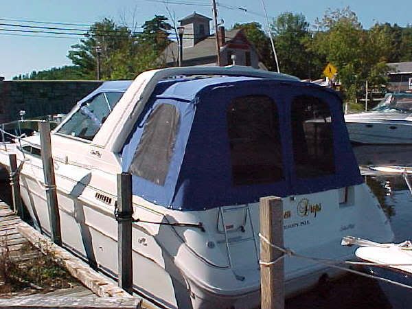

OK....I've replaced windows in enclosure panels before. But, I haven't had to replace screens yet. Made an enclosure a few years back and the client wanted no-see um screen. Now they're all torn to shreds and need them replaced with heavier screen. I really don't want to disassemble each panel.
So, I figured I could cut the new screen to size, bind the edges and sew it on to the outside of the panel.
Any other ideas out there?
