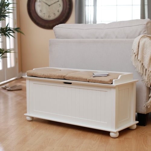

I tried to find a photo similar to my design.   This was the closest that I could get.   It's similar to this except the corner posts will go all the way to the floor, have a taper on the last 2" and there is no base molding.  And it will be natural finish, not painted, and have some intermediate stiles.   Other than that, exactly the same :-)
Exactly like this, only different.  Lol.
I would do a loose cushion. The raised rails on 3 sides will keep it in place fairly well.
