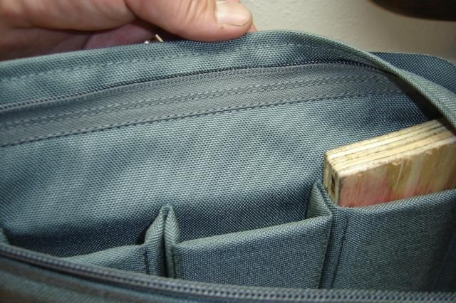

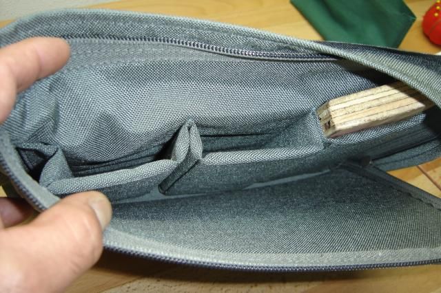

I have two versions of magazine holders now, one for the inside of a pocket I call sleeves (open bottom) and a version 1 for the outside.  The sleeves are working out fine, the outer pocket is just a sample that came out okay.  Pictures to follow.

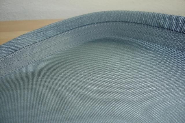

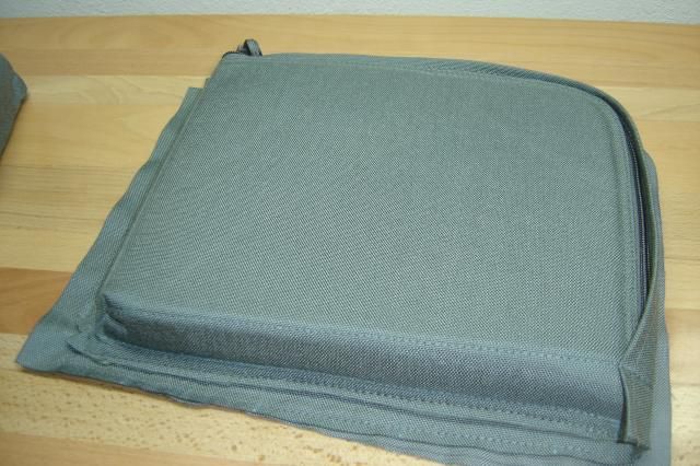

My failure this week and weekend is how to properly end my zipper (lets not talk sizing of my outer cover, my ever ending headache).  I know, zipper ends, sounds simple right?  For me in this particular case I have failed, and failed, and failed again.  Duh!  So today I put everything aside and worked outdoors.  I know I can get this but you all have given me such good advice, I thought I could at least show you where I am going and yes, even my failures.  I am a newbie and realize that so it gives me comfort (but my wallet screams other curse words)  :).  Thank goodness I am not doing this for a living....yet?
This is a two magazine sleeve sample.  I can sew them together tightly if only two but not three.  Bummer, I like this look.  Please disregard open edges on the sides, a sample only.  It is lined with 1/4" sew foam.
My Version 1 of an outer 3 magazine holder.  Of course it would require Velcro or snaps to hold down a cover flap.  I can do either.
What I am trying to create (outer picture).
yes the bottom left corner is bad, corrected on another cover (That still failed).
Inside before much is sewn.
This is what is all about, 3 internal sleeves.
We are getting there but this weekend was supposed to move faster and less expensive.  At least I hope you all can see that I have some talent (that is questionable ha ha) but am making some headway.  And yes, this is the hardest design I have done yet, a simple rifle case is peanuts compared to this.  I will get there...
