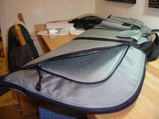

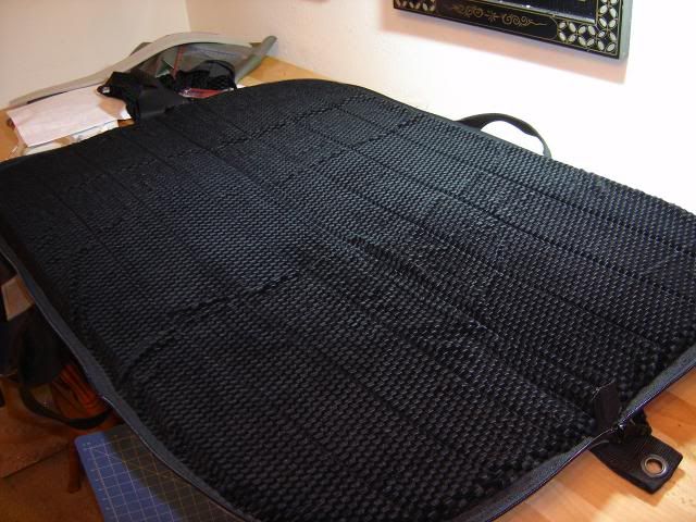

Chris, Semper Fi!  And feel free to harass me all you want  :).  And for my Bernina, it has a very narrow bobbin so 69 thread as the heaviest works best for it.  I'll try to upload a few photos of my learning curve to see how they come out.  The first was only my second case I made, did it over 1 1/2 years ago.  Mistakes are obvious and I have corrected my methods but here it is.

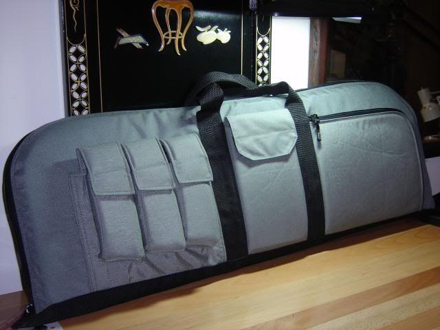

Lots of cons - I don't like the shape, it was too tall, too many wrinkles, bottom webbing was 1/2" off from end to end, etc.  I tried to run a marathon whereas I should have walked a 5K.  For larger picture I hope  http://i3.photobucket.com/albums/y72/welcometoalsworld/Rifle%20Cases/010.jpg

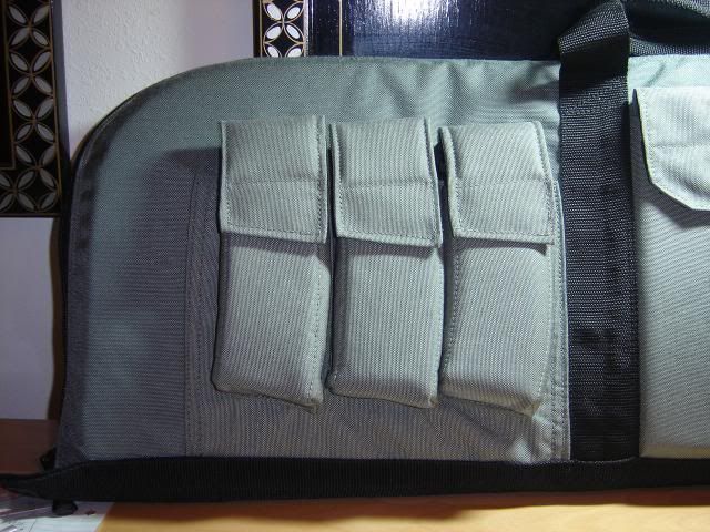

An idea I haven't seen anywhere else, foamed magazine holders.  They were effective but each came out inconsistent of the others and were difficult to attach.  I can improve on this.  http://i3.photobucket.com/albums/y72/welcometoalsworld/Rifle%20Cases/011.jpg
Not perfect (notice the sewing edges around the zipper) but the idea is one I work with.  There is no "inside" of the material visible.  I double over and foam lined this (1/4" sew foam) so only the outer smooth side is visible.  Better abrasion protection for whatever is placed inside and hopefully adds some "class".  It does use more material albeit not by much.  All pockets are done this way, no rough side of the material can be seen inside any of them.  http://i3.photobucket.com/albums/y72/welcometoalsworld/Rifle%20Cases/015.jpg
Oh the horror of my mistake here.  Beautiful Envoke Velvet cloth from Miami Corp that I completely screwed up putting on.  It was my first try with adhesive and I did everything wrong.  Should have practiced first, got help, not rushed!  So, I tried sewing to keep it smoother (see the long lines sewn in) and it's functional, but not a good job.  I have learned and have pictures of another case where I fixed that.   http://i3.photobucket.com/albums/y72/welcometoalsworld/Rifle%20Cases/018-1.jpg
I make things differently now, but overall for only my second case it turned out fair.  Great lessons learned, but these photos might be better suited for the "How Not to do things" thread on this forum.  I will post some more of improvements on a different case.

Nice looking work for just starting out!  Keep it up and refine as you go and they'll be flying off the shelf.
I like the magazine clips, but if you sewed 3 pouches then appliqued them to the front of the case, I can see where they'd be a nightmare to attach.  I'd be tempted to make a large pouch (big enough for the 3 clips), dart the corners where necessary, then sew the large pouch to the face of the case.  After sewing the perimeter, run a stitch line through all layers between the clips, effectively making 3 out of the one.  You'll lose the curved styling, but for a lower-cost "production" model, it may work.  Actually, with practice, you could probably add the curve.  After the pouch is sewn on, add the 3 cover flaps with velcro or whatever fastener you're using.
As for foam, if you anticipate these going hunting, I'd use closed cell simply because it's more impact resistant and doesn't absorb water.  One really kool idea might be a rain pouch that covers the whole enchilada.  My daughter has a very expensive camera bag that has a small, sewn-in pouch near the handle.  In foul weather, just open the pouch and pull out a super-thin waterproof cover (also attached to the bag).  The way it's sewn and attached makes it a 20 second to install cover that will never get lost.
You might get lots of design ideas from etsy by looking at camera bags.  For instance, you might add a detachable shoulder strap so you can sling it on your back while hiking.
Oh, and fabrics with a nap like velvet and velour are difficult to sew on ANY machine without having the fabric creep.

I don't look at a lot of bags closely and was wondering about your xipper and if there shouldn't be more hidden , im just compairing to a cushion zipper that would have flaps covering it

June, I am going to try your ideas on the case I am making.  He wants them (magazine pockets) inside a zippered pouch like shown above so they will have no cover,  but I need to just make them straight and find out how they turn out.  I think it will work fine for this project, and will experiment in the future.  Concerning open cell vs. closed cell foam, yeah I debate that daily in my head.  I know you are 100% correct about moisture retention and what I currently use will soak it up.  I can get open cell locally, but finding closed cell is more difficult and quite a bit more expensive.  I do not have a definitive answer where I will go but still shopping for closed cell.  As soon as you said a cover the first thing that popped in my mind was Silnylon, silicone impregnated rip stop nylon.  I could easily make a small, lightweight waterproof cover and incorporate a pocket to retain it.  That may be my initial starting idea if I stay with open cell foam for now.  Still shopping for that option.  As for a strap, yes I have put shoulder straps on two of my cases (opposite side of the pockets) and will put one on the project currently in-work.  He specified how he wanted it so it will be a little different than previous ones, but not difficult.
Mike, yes yes yes I want a flap covering the zipper but I'll be honest, I just don't know how?  I want to warranty the zipper for a long time (it's the last thing I install, I can easily repair/replace if needed and the only real failure spot I can foresee unless I make a mistake).  But it is too exposed and welcomes me to do rework if I don't incorporate something to protect it like a flap.  Rework only cost me time and money (not to mention customer dissatisfaction) so it's something I must learn and incorporate.  A metal zipper may be able to withstand more abuse, but if I leave it out there exposed to get abuse then I have made a quality product with a flaw.  A very valid point that I need to find an answer to.    Concerning hours per bag vs. cost, right now I am tremendously slow and inefficient.  I do know how to improve both but have moved slowly as I pattern and re-teach myself the basics.  My business is not up and running yet (launching in June) so I have a ways to go.  Just these past two weeks I was able to get all my business requirements done (11 digit tax and sales use number, EIN number, Doing Business As) received but I must get better and get my system down.  What I am showing has all been for practice, friends and family.  Honestly I am real ignorant concerning how to pay myself so I know I have tons to learn.  But I have to start somewhere and so far it's a very exciting time, and a long time coming.  I have a ways to go for sure.

I have to agree with June. When I make my ladder buddies ( textilene bags that strap onto ladders ) I make the pouches oversized. I stitch one side and then stitch across the bottom after sewing darts into the corners. Once it is sewed around its perimeter I then separate the puche into smaller pouches by sewing a double stitch line up and down. Saves a bunch of time in cutting and stitching.
I think your cases look great. Heck I would buy one if I needed one. I think your on top of your game and will have them perfected in a short time.
In regards to your mag pockets, take some scrap material and try doing what June and I suggested. You will get the hang of it in no time and find out how easy it is to do.
