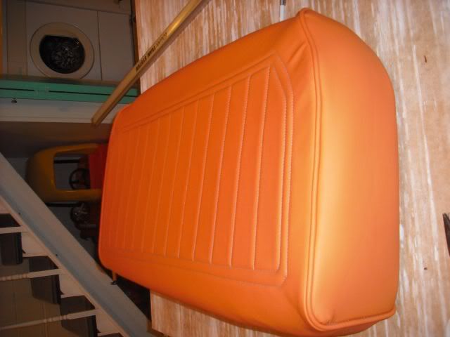

I'll take some pics...

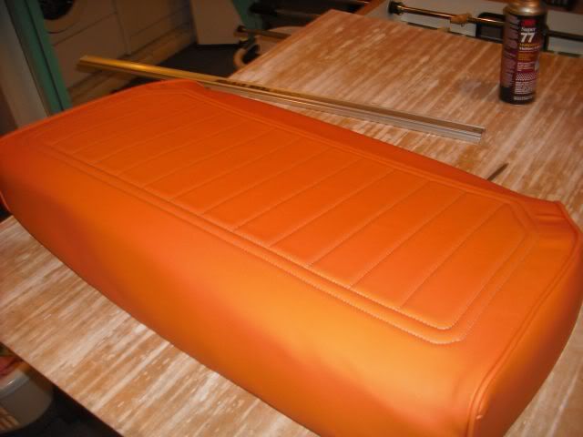

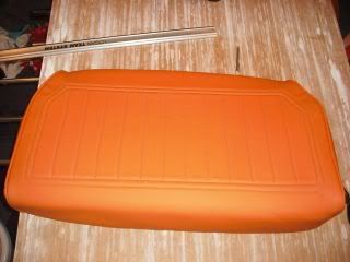

February 08, 2011, 05:48:01 pm #6 Last Edit: February 08, 2011, 05:49:50 pm by mpm32
Here are some pics, keep in mind the skin is just sitting on the foam and not stapled to the seat base yet.   I'm pretty sure it will look nicer once I do that. I do think that by the time I get to my last piece in this boat I will look at this first one fondly and then do it over as I'm sure I'll get better as I go.

The topstitched center seat piece in the pic is the second one I made, I messed up the first one - lol.
