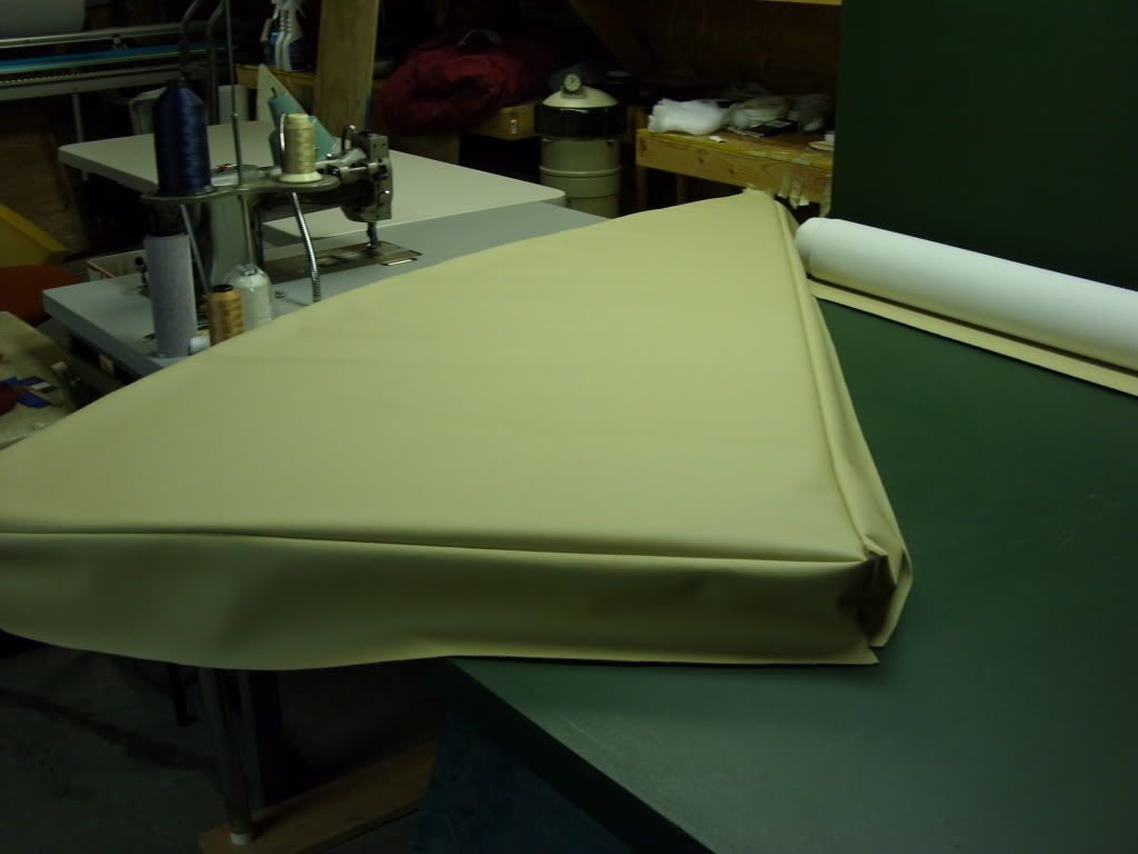

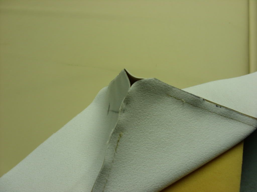

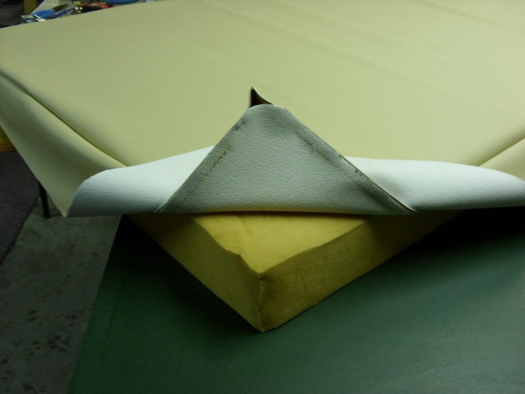

     I'm having a hard time with the intersectsons.ive mess up 4 or 5 now
Can anyone tell me the right way to do french seams that intersect.
I no I have to sew around the corner first
should I sew the boxing first then sew the boxing to the plate
And how should I cut away the selvage at the intersection.
Hear are some pic of the work
                                               Thanks  Mike H

i'm no expert but i would sew the boxing first then attach it to
the plate.
I think i would avoid the boxing ending right on the corner,
In that case i would sew most of the boxing on ending away
from the corner leaving 2 or 3 inches either side of the join un sewn
then join the boxing and top sew, sew the final part of the boxing to the plate
going over the boxing join.

As Richard states, try to avoid boxing seams right on the corner.  It really makes life difficult.  Having said that, I've done it before.
  http://www.harborcushions.com/photos/P1010131.JPG
Sew and topstitch the boxing first.  Then sew boxing to the plate.  Both the boxing and the plate will have to have "V" notches cut to avoid bunching under the seam.  In my pic, you'll see that I could have cut more/bigger "V's".  It's a little thick on the corner.  When sewing the topstitch on the corner, more V's makes it hard to keep the selvedge spread open, but is absolutely necessary.  I always turn the piece right side out - as it will be installed, and look in the corner to see if there's a wavy/wrinkled mess of selvedge that indicates more needs to be cut out.

So this is a v-berth cushion where the foam is undercut?  The corner is the logical place to put a seam in the boxing for those, but you can place seams a few inches off the corner on both sides if that's acceptable.  On V-births, I don't typically do french seams on the boxing - just on the plate/boxing seam if that's requested.  You're going to have a heck of a time getting into that acute corner to do topstitching unless you have a post-bed machine.
I was thinking about this thread while cutting/gluing/bevelling foam for a large interior job I've been working on.  I never topstitch cushions that way unless it's a customer specification.  Rather, I topstitch the allowance of the boxing and the top/bottom to the boxing.  It reduces the amount of notching to the corners (or the relatively unusual concave arc) as there is no excess fabric to "squeeze in" and limiting the needle holes means less water gets inside the cover.   It also makes topstitching the acute angles of a bevelled cushion considerably easier, as June pointed out.  It's also faster as  you only have to drive around the cushion twice instead of three times.  ;)
I don't generally like to have a seam in the corners, either, although on cushions with a bevelled edge it's normal to end the zipper boxing a the corners.  Here's another trick to try if the seam is going to end up in a corner:  when you stitch the boxing pcs. together begin and end your seam shy of the edge by the amount of your seam allowance.   Do the same thing with your topstitching.  This has the advantage of leaving the boxing "open" at the corner.  Drive to the corner and backtack.  Begin stitching on the other side of the corner and back tack; you are effectively starting and stopping precisely at the corner.  This is a tailoring technique typically used on bound buttonholes, welt pockets, and notched collar and lapel applications.  Very useful trick to know!

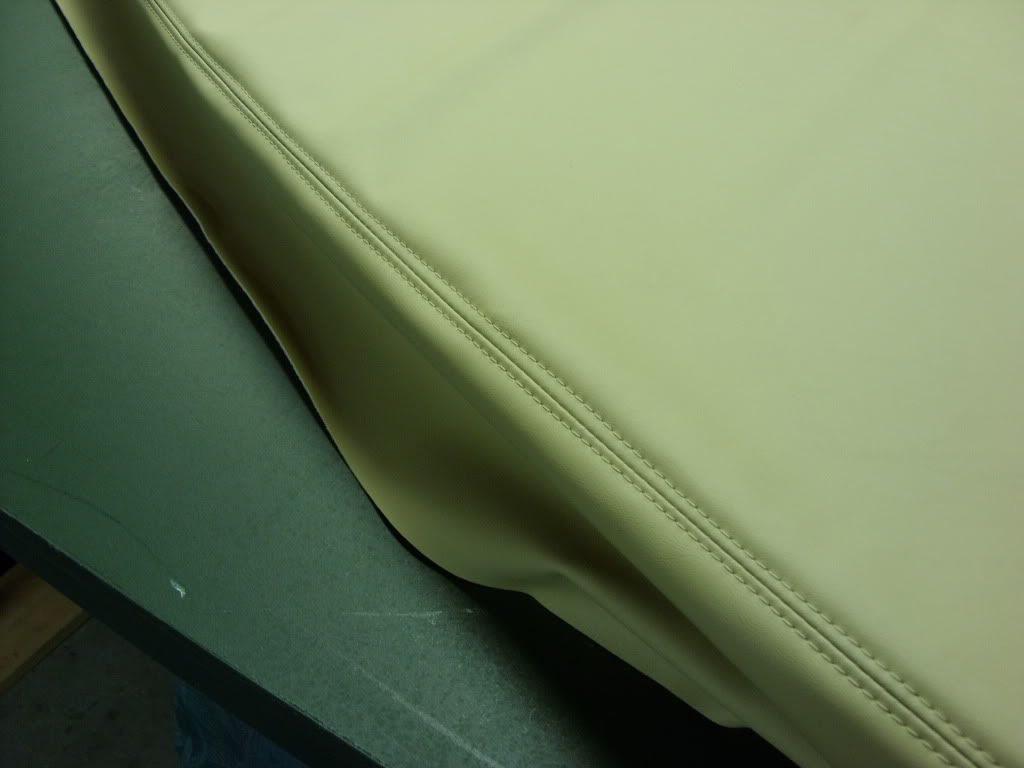

http://i275.photobucket.com/albums/jj300/dadhuff/Sewing%20New/SN850303.jpg
http://i275.photobucket.com/albums/jj300/dadhuff/Sewing%20New/SN850304.jpg
                                            Mike H
Juki 563
Your topstitching is as neat as a pin.  Not much room for error when working with vinyls or leather! the holes don't go away the way they do on wovens.
