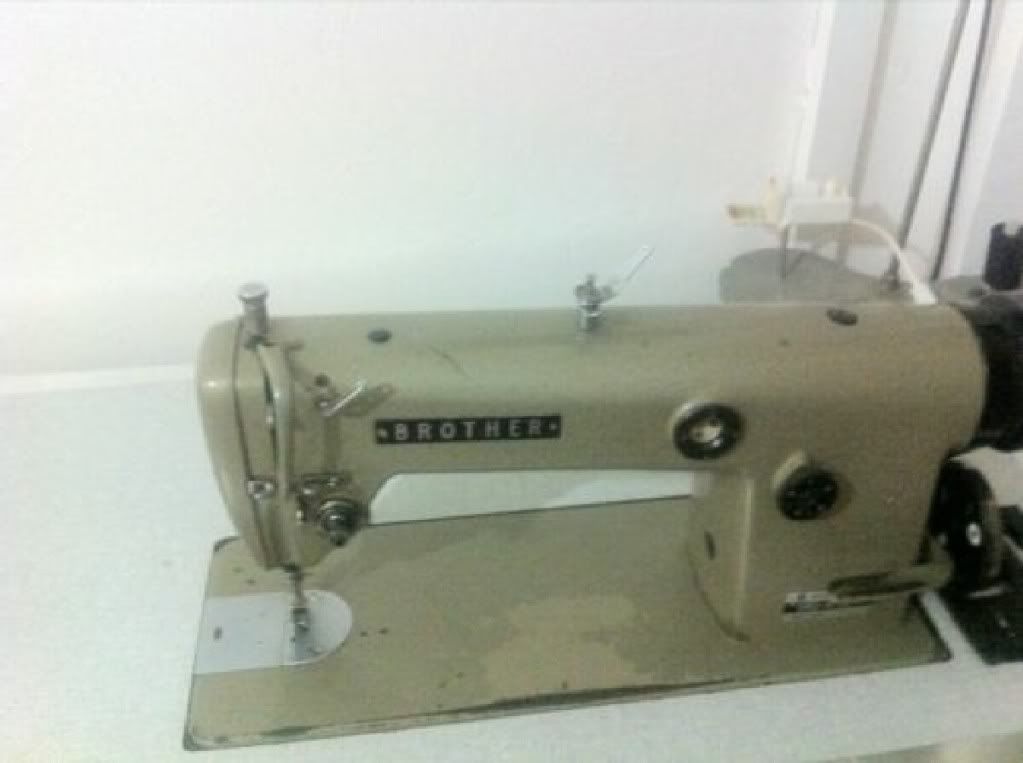

Could someone ID this brother machine i got on ebay please.
It has a servo motor so worth the £137 sterling I paid .
Throw us a bone, Rich! how about a serial #?
The head looks like the same one I used to work on in the early/mid '80s; that machine was a basic, high speed drop feed machine, though it was a full function machine (tack and trim).  Your new machine doesn't appear to be full function.  I'm thinking the motor is new?
At that time, I preferred the full function machines offered by Brother and Mitsubishi to those from Juki (there was one in the shop and everyone hated it!).  They functioned more smoothly and allowed greater range of adjustment.  Juki clearly went "back to school" and put a lot of time, research, and engineering into improving their line.
My guess is that if it's a drop feed machine you will really like the way it handles the lighter weight fabrics you encounter, although you may not like the way a basic, drop feed machine deals with multiple layers of cloth... think of applying welting... or working on upholstery velveteens/chenilles.  But it can be done! trust me, I did it for years on my 1929 Singer 31-15 and machinery doesn't get more basic than that.
How did your chenille project turn out?

I bought the machine hoping to use it on the chenille job.
do you think I may have wasted my time ?
Not necessarily, Rich.  But I'm not savvy enough about machines to be be able to tell whether it's a needle feed machine or a drop feed machine by just looking at the picture.  But if it's a drop feed machine and you are unaccustomed to them (the feed dogs are the only thing moving the fabric under the needle) you may find the presser foot will have a tendency  to push the top layer of cloth forward on the bottom one.
That was what my 31-15 used to do when faced with heavier napped fabrics.  I recall one very frustrating experience with an upholstery weight velveteen that convinced me to purchase my Juki 562.  When it was time to replace the 31-15 I knew I wanted a needle feed machine (the needle bar moves forward and helps feed the goods from the top as well as the feed dogs, but there is no walking foot involved).

you're right its a drop feed machine and i've not used one before
my Juki is needle feed and so was my last machine.
It hasn't been delivered yet so i'll let you know how i get on with it.
As for fast, my Juki has a variable speed that is controlled on a computer
panel so i normally turn it down to 2000 spm. this new/old one
is 5000  EEK ! but i'm hoping with the servo motor it will be variable
so i can dial it down.

Drop feed means that the needle bar goes up and down only, the feed dogs are the only way to move the fabric under the needle.  Most "home" machines are drop feeds.
Needle feed means that the needle bar actually moves forward pulling the goods under the needle from the top while the feed dogs pull it under the needle.  You get a very even feed.
The machines that we typically use in marine canvas/upholstery are needle feed machines with the added feature of the walking foot.

I got the machine because it is a lighter weight machine than my Juki. The compound feed thing
is just a matter of terms i think, different people call them different things but they are the same.

I ended up stapling the Chenille together, reduced the tension, used a 16 needle and it looks loads better
thanks. It is taking forever to sew though.
My machine has a foot height dial on the top so i can step the foot higher or lower for thicker fabrics
so i have been stepping the foot higher also.
