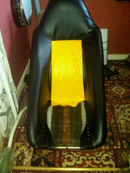

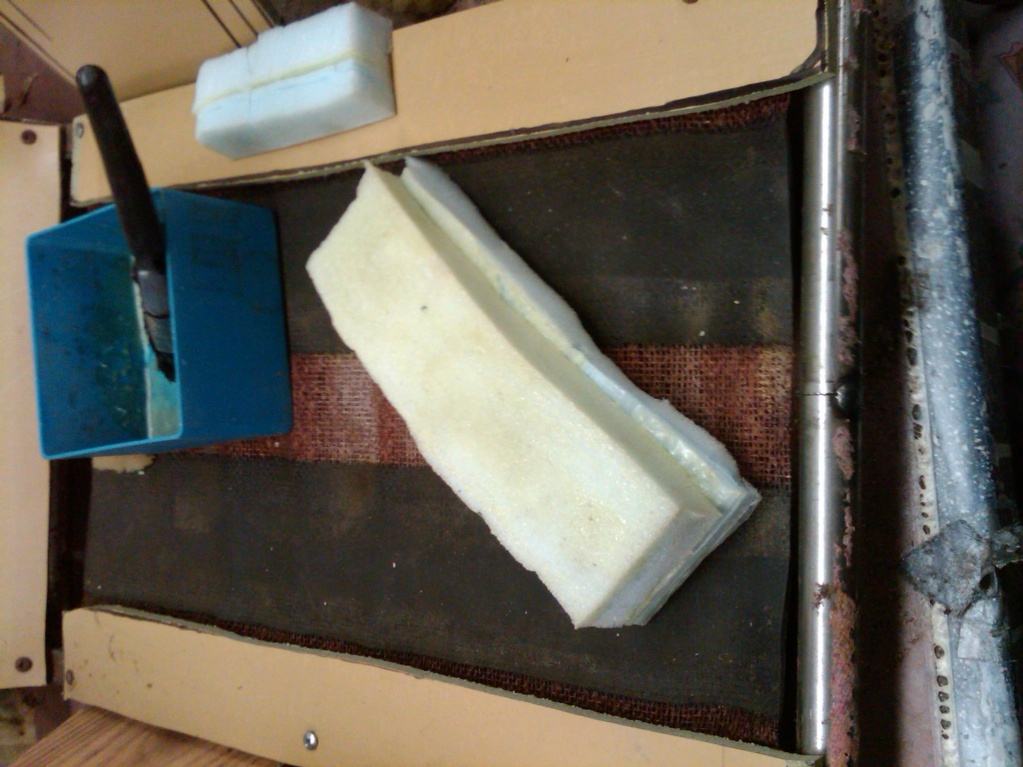

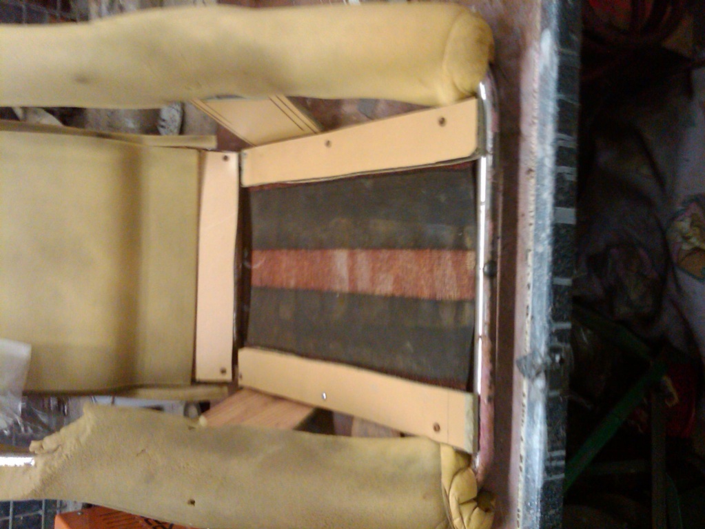

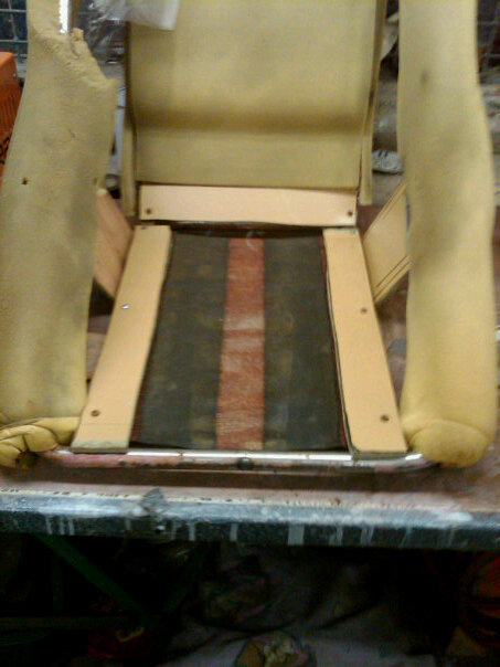

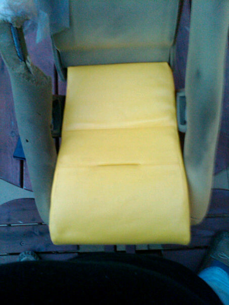

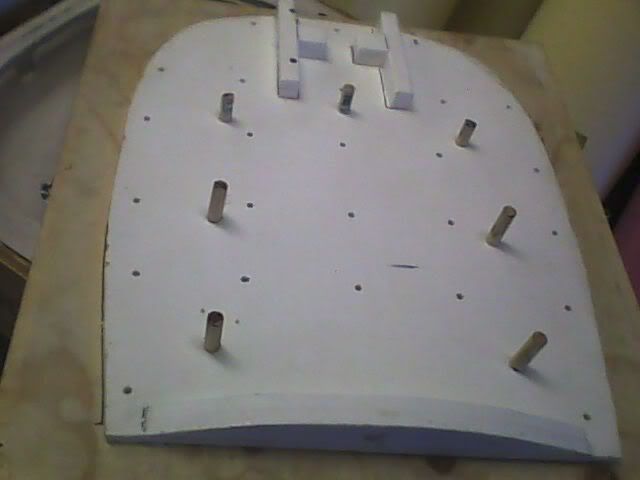

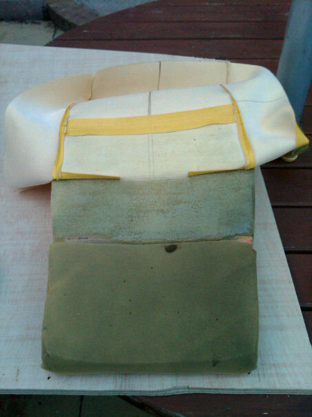

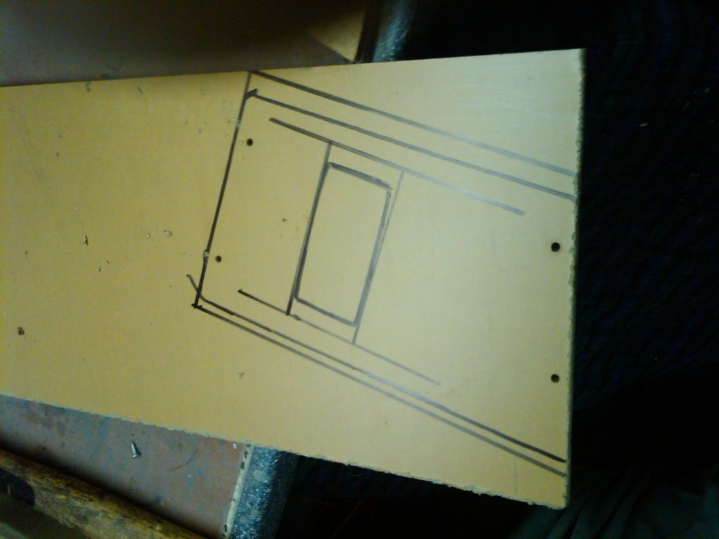

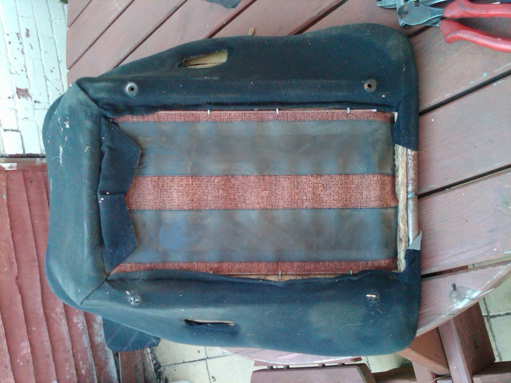

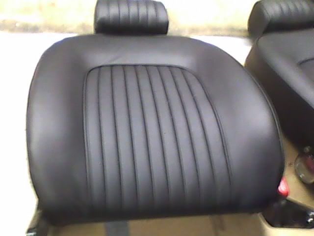

Customer wanted all new foam. The cushion foam is available, but not the backrests! Here's the finished b/r's

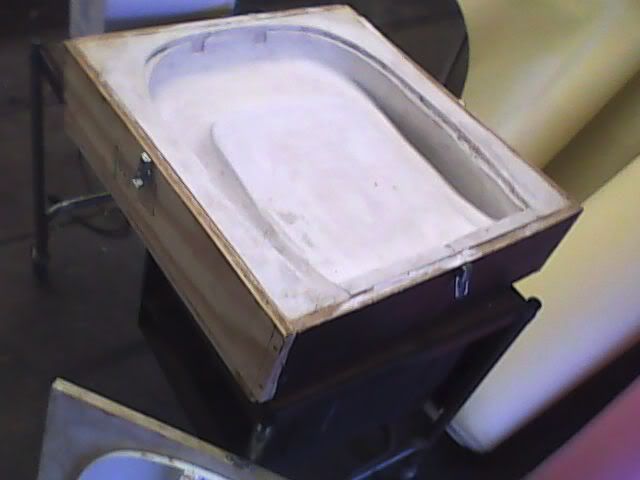

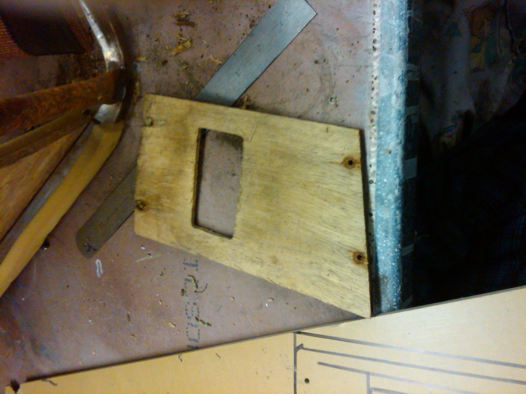

I made a mold and poured new foam:

Very Cool!  Tell me more about your foam molding....Materials used, material sources...etc
Thanks,
Loren
206RB
Sure, Loren.
I made a mold box out of plywood and a "plug" out of starboard, Then used plaster of paris to make the mold. I used Smooth on flex foamit X for the finished product. There's lots of videos on their site on how to do it.
Saddleman
Great ideas.  I have used some of Smooth On's molding materials before but not their foam.  Thanks for sharing.
Loren
206RB
Quote from: Saddleman on November 24, 2010, 05:23:15 am
Loren
Loren, depending on the demand, you could incorporate those gel pacs into the mold very easily. That would be a fun project.
