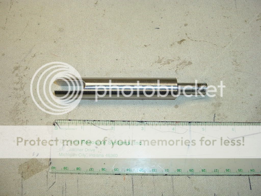

I have 6 dining room chair slip seats at the shop. Today I cut the fabric around the edge along the bottom of the wood frame. I then took a 7/16" drill bit in my cordless drill and wrapped the beginning of the welt cord around the drill bit. This is the welt cord that runs around the bottom of the slip seat. I then ran the drill all around the bottom of the seat and the welt cord came off. It was really, really easy. No strain on my wrist or my drill. I was actually surprised.
I then went around the seat bottom and pulled out the staples that were sticking up.
The only issue I had was getting the wrapped welt cord and fabric off the drill bit. I can see where the stripbit would allow you to slide the stuff off much easier.
I'll let you know how the stripbit works when I get one.

I will give credit where credit is due. Absolutely awesome!
I worked on 8 dining room chairs today. I cut around the bottom edge with a razor blade knife. I pulled up a bit of the fabric on the bottom of the frame, stuck it in the slit, and away I went. It works exactly like the video.
I did have a machinist friend with a metal lathe make mine.
I had to work at it a bit a few times, but it definitely saves a lot of time. It leaves a few staples sticking up that are easy to pull out.
Also, I used my cordless drill. It put a lot of torque on it, so I think I will try the electric drill the next time.

What about particle board dining room seats? It seems like it might pull chunks of wood off with the fabric.
Is your home-made one basically the same? How about a pic?

Here's a pic of my home made one:
http://i830.photobucket.com/albums/zz228/genejoe/boat/DSCF2124.jpg
I prepped a sofa today. I used it on the welt cord around the bottom. I used this little baby to take off the ply grip on the back out sides, and the chip strip across the back out top. I used it for the ply grip on both outside sides.
I always try it on any welt cord, ply grip, chip strip, and on fabric that was cut and there are strips of it still stapled to the furniture, on the bottom for example, that I want to take off.
It does not always work because of too many staples, for example, but I am at a place where I always try it first.
Look at the video. That's how it works for me.
On mine, I would have had the slit made about 1" deeper.
Also, I spray just a bit of silicone spray on it when I know I am going to have a really long run. This helps the stuff to slide off the tool. Sometimes I need to run the drill backwards and sort on unwind the stuff. I can usually pull it off or knock it off with another tool like a screwdriver or a small hammer.
Be careful kids, it can wrap your fingers and arms up in the stuff you are pulling off very quickly. Those of you that prep furniture with your tongue hanging out may want to stick with the Berry staple puller.

I started on 8 dining room chair slip seats today. About 6 and 1/2 million staples in each seat and the wood base is MDF. Yuck!!! I cut around the edge of the seat near the welt cord with a razor blade. I put the end of welt cord in the gizzmo and off it went. I put the gizzmo into the cambric and off it went. I pulled up tabs of the fabric strips on the bottom and off they went. The main problem was in the corners where there were most of those 6 1/2 million staples.
It does put some strain on my wrists and drill.
