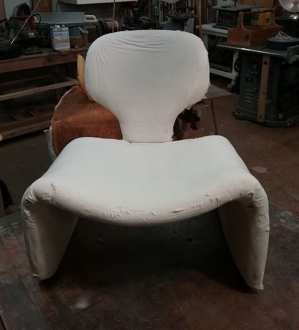

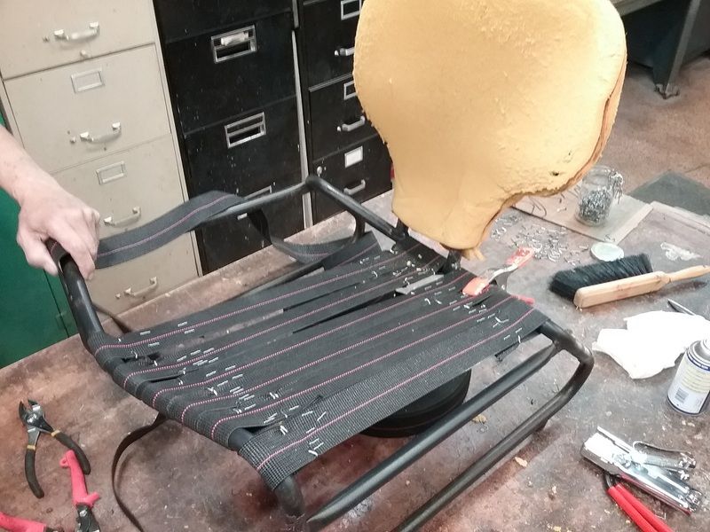

Gene back in Jan I had two modern steel frame chairs to do ...the foam was ok but the perilli straps were shot.  I have a heavy duty hand stapler  that I used to attach one strap to another while pulling the opposite end tight.  Then I used hog rings to give the strap connection more strength.  I was on the last strap and while squeezing the hand stapler I ruptured a tendon in my finger.  Dr. said it's trigger finger and will heal 100 % - it's been 4 months and it only feels 50 % better.  Anyway I went on ebay and bought a pneumatic plier stapler for $ 25.00.  an old one but it works great - you only need 40 lbs pressure and the staples are stronger than the hand stapler so no hog rings are necessary.  Didn't get another job for it yet but I'm itching to use it.
Steve do you have a photo of this? I can't figure out what you are taking about.
One manufacture I work for used a long jawed pneumatic stapler to attach the seat front to the spring cover. In all the years I've been recovering furniture I have never seen this method. It was rather odd.

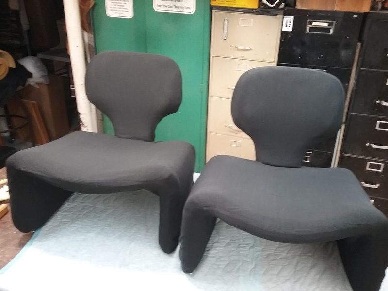

Ian this was a pair of Mid Century chairs - the seats were redone because the straps failed.  We kept the original foam and slip cover since the customer didn't want the expense to change those materials.  The slip cover is dark gray.  I wrapped all the foam with muslin glued on to help give the foam a few more years.  Only the straps on the seat had to be replaced - the stapler in the photo is the one I strained my hand using.  That finger is still messed up.
