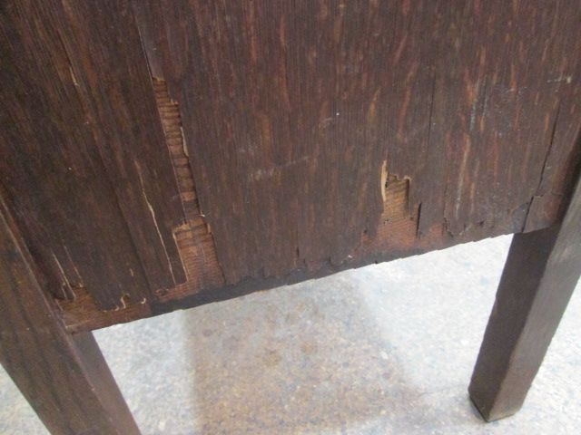

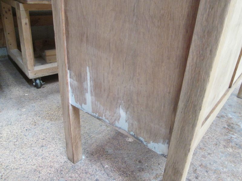

This Craftsman Oak side board came in last week.  Stripped down everything, bleached the top w/oxalic acid, glued down loose veneers and filled them in.  You don't always have to patch in with new veneers.  For veneer loss like this it's easier to fill in and faux color the putty - the look will be better than veneer patches.  The only way to fix the veneer correctly would be to re-veneer the entire panel and this job doesn't require that level of repair.  For filler I started with Elmers interior exterior water based product. Sticks well - stays put. Following that - Sanded smooth - still could see course filler - next -  feathered in with timber mate using it as a finishing putty.  The surface became smooth and imperfections couldn't be detected with your finger tip.  Customer wants a brown finish - for me golden oak is the way to go but their choice.
Timber mate is a great product - comes in colors if you rather, and unlimited shelf life.  Sands so easy that you can use it on a finished surface to fill a dent and sanding can be done with 240 garnet which won't hurt a finish.  Timber mate reminds me a little of the rock hard water putty which also does the same thing but you have to mix it and apply it before it hardens.  The whole piece has been sanded now - the dried oxalic acid rinsed off before sanding - one last thinner wash and I have to think about a stain.  I want to use dye but I think I need something more covering like a wiping stain to hide the patches and black ring marks I can still see a tiny bit.

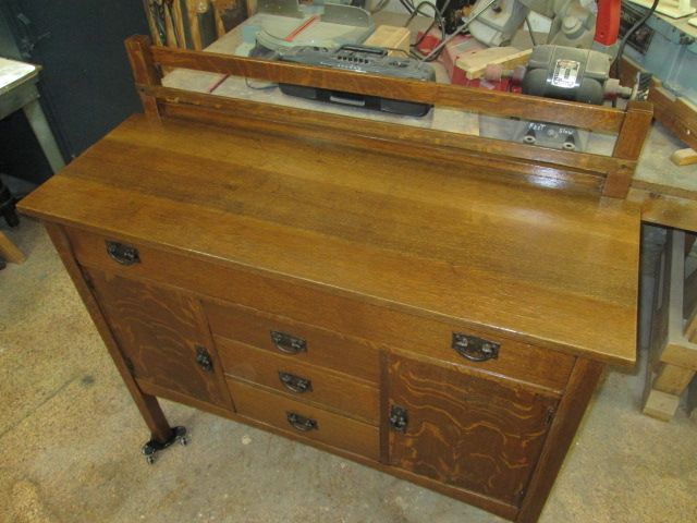

Used the wiping stain - perfect brown - a little more to the green side but helped off set the orange tones of the wood.  The filler was retouched with qualasole and earth pigments - raw sienna and walnut. Than the piece including the filler repairs was stained with the wiping stain.  The filler has gotten to a nice back ground shade color like the rays of the oak - sprayed sealer and after sanding the sealer will start to add some graining.  Yesterday I was searching for reviews on bing for an anti virus.  This morning at photobucket I had to x out of 5 anti virus adds :)
Touch up all done - sprayed sealer and clear over the entire project.
