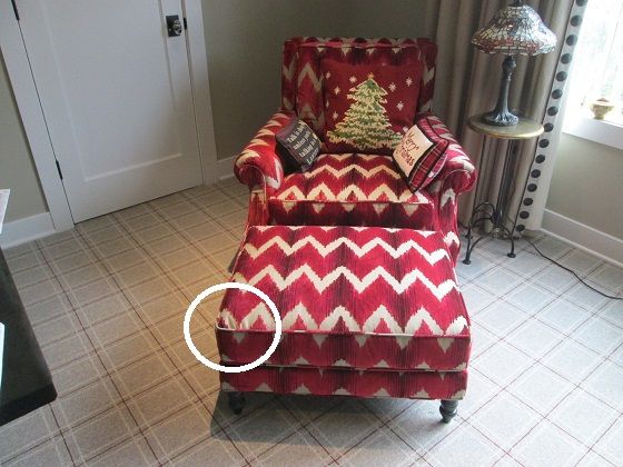

An account asked me to make a service call to fill the corner of the attached top cushion of an ottoman.  I'm bringing the regulator but is there a way to access the corner if I remove the dust cover or not even possible ?
You could remove the dust cove and then cut a slit into the spring cover (burlap?) there may also be some type of padding you will have to rip through. This should give you access to the zipper, if there is one. The fun part will be trying to get your hand in there.
Then when finished hand sew the spring cover closed. Problem is you never know what you'll find when you take the dust cover off. If its plywood you're out of luck.
Any time I go on a service call like that the small compressor. stapler etc,,,in case I have to rip something down to the frame. Oh yeah---and a drop cloth grin,

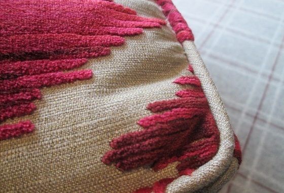

Went to the residence today and tried to reshape the corner by forcing the foam forward from the far side while holding the case - not much improvement.  Tried the regulator - no help.   Looked under the dust cover but a view up to the corner of the cushion is blocked by a sheet of synthetic burlap.
This may come into the shop and short of taking it apart I was wondering if I could make a hole in the synthetic burlap or with a seam ripper try yo get the fabric apart just at that corner then blind stitch back.
I'd try a hole in the synthetic burlap first.
You're right that sounds a lot safer than trying to un-stitch the corner -
I also tried some steam - helped a bit but not enough.  Either they didn't wrap the foam or they didn't cut out the v's on the turn when sewing or maybe just bad sewing ?
Thanks,
I agree with sofa. Try to access the attached top cushion through the synthetic burlap first. It would be best to do this in shop so the customer does not see you cannibalizing their ottoman. I'm guessing there just is not enough foam to fill attached top cushion. Any chance this is a down envelope with foam inside?
