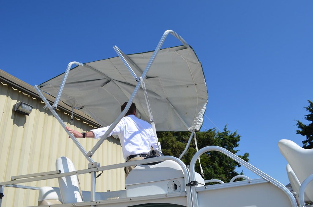

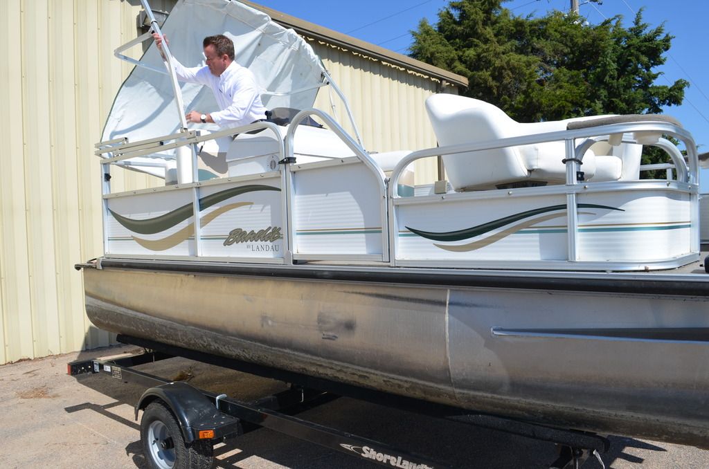

Mike:
Here are the two pictures I took.
First is of the "mini-topper" -- as you can see, it is the same width as the pontoon:
This is just the side of the pontoon.  I won't say for sure that it is 6' versus 8'.  Would like to go back and remeasure and am kicking myself for not taking a picture of the old topper but knee was really po'd by then as I climbed up inside the thing.  First step was a killer.  May try and go back tomorrow or Monday if schedule works out and look at the old top.  Anyway, here is the other picture:
Any pricing advice you can give me would be greatly appreciated.  Don't want to bid too high but want to get a price that is fair to me as well.

im not sure what a "topper measures 12.5' x 6' " on a 16' pontoon.
but to replace the bimini canvas  6'x6'
5 yards od canvas 5 zippers for zippered pockets  $ 480  and ask then to bring the boat to me more as travled requires   if you need to make a full snap on cover?  $ 1075 again bring to me  moew to travel and pattern

Yes, it is a full snap-on cover.  I had a guy helping me to measure (holding the tape) and he always came up and looked at the end of the tape I was holding to see what the measurements were.  My brain just kicked in.  It is 16 x 8 as it is full snap on.  I was measuring end to end and didn't include wrap around fabric to get to the existing snaps.  Also didn't know what the correct terminology was.  Now I know what a bimini was and that I should call the main cover a full snap-on cover.
When you factor in canvas, snaps, zippers prices aren't as excessive but sounds that way at first.  What canvas do you normally use.  I ordered a Sunbrella catalog a few years ago but I'm not sure if there is a better marine canvas to use or not.  No travel as the boat is at a car dealership less than a mile from our house.  Boat would not fit in our garage and I would probably get a divorce if I tried to put it in there anyway as Mr. Corvette does not sit outside (so says husband).  My HHR is always outside but whatever.  I will also pick up the old canvas on both the cover and bimini.
