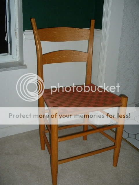

Here's a chair I refinished and repaired and they cane
Many years ago, I took a class in making a ladder-back chair in the Appalachian style.  We started Monday with a log on the ground and by Friday noon we had a chair.  Only tools we used were wedge and sledge, froe, drawknife, spokeshave, chisel and brace and bit.  It was based on "Make a Chair from a Tree" book.  Every piece of that chair had grain oriented a certain way and dried to a certain level so the joints locked together when reaching EMC.  The instructor said we could use Hickory bast to weave the seat if we wanted to go out to the woods in the spring, drop a hickory tree, pound the bark, split the bast, smooth it out, and soak in water to weave.  That week he was fixing one of his chairs that his wife had decided to stand on to swat a bug and broken the seat out.   I opted for the Shaker tape.

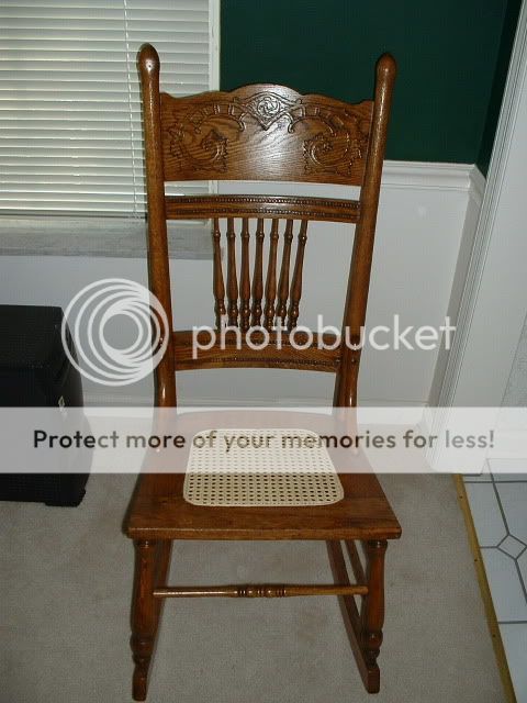

Nice little pressed back - I like the dark color.  Some folks have sets of these oak chairs.

Are you going to stain the cane seat ?  Looks natural

I've also always wondered ( having never done it) how are the ends of the canes, like Steve did, secured to the frame?
I have not found a good way to darken cane other than age.   Nothing seems to stick to the hard surface and trying to dye from the back didn't get me far either.   I've had to repair some and just used a bit of toner.   I don't know what the factories use, but then again, if I have to repair the chips, it must not be very durable, either.

The ends of the splint are stapled and glued to the underside.  If you didn't want to use staples use white glue and a pinch clamp -
