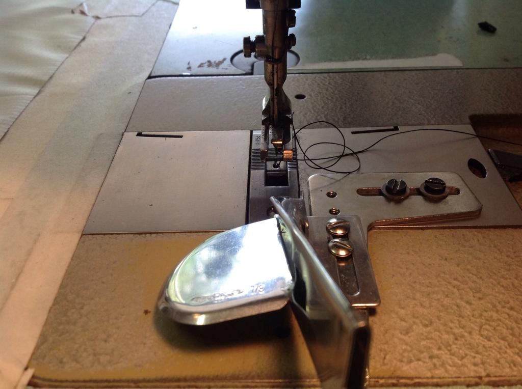

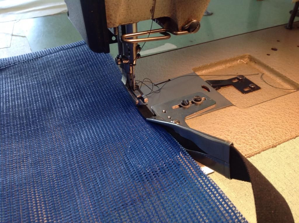

Old sailmaker
Heres my set up, 7/8" double folded binding, attachment. The folding is what screws it up
If your binding isn't being caught on the underside my instinct says that the folder is too large to keep the binding steady as it's fed under the needle.  But sometimes a "gut feel" isn't right.  I noticed that you have a welting foot on the inside foot and I wonder if poor contact with the feed dog is allowing the binding to "wander"? have you tried putting the regular feet on your machine to see if that helps with steading the feed of the binding?
Since you're binding straight runs you probably don't need a right angle and the set up you have ought to work fine.  I have friends who use that set up and it does what it's supposed to do with no real issues.

@bobbin, thanks i will change the foot and if that doesnt fix it, in the garbage it will go and i will try and find another one. Thanx yall

I do like to angle mine a bit helps on inside curves what is the exact problem is it as boobin said not catching the bottom  when sewing?

Is it set too far back from the foot or is that just the photo?
I have mine just clearing the foot in both directions
I would have thought you wouldn't have too much trouble on straight runs otherwise
