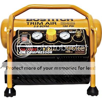

Here's the one I settled on after the first one I purchased was way too noisy, constantly ran when stapling, wouldn't seat a 1/2" staple completely, and smelled as if a bearing was going out on the first use.
This unit has been handy for those occasional on-site jobs. Works great for staples, brads, and spraying glue . . . only thing it doesn't do well is using a bazooka for fill. Used it exclusively for about 5 weeks while waiting for repair parts for my primary unit.
Here is a site that has it on sale for less than I bought mine off the shelf . . . http://www.factoryauthorizedoutlet.com/bostitch-cap1512-of?CA_6C15C=230005750000000566.
