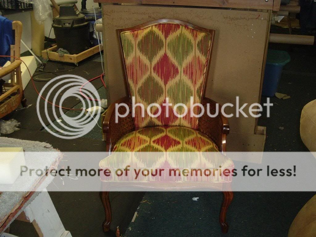

I did this chair on Monday. It's a very expensive, and very very stretchy fabric. And, it's a loose weave fabric. The seat cushion is a T with a rounded back: warp, waft, and bias sewing.
I may have gotten this idea from this forum, and if so, I'm sorry I can't give credit where credit is due.
I ran a small bead of adhesive fabric all around the edge on the wrong side of the pieces, let it dry, and it sewed quite well. I would not want to do this often, but when needed it helps a lot to keep the fabric from stretching.
You can use single sided interface but with the rounded back that gets to be a pain.
PS: I got some garbage out of the can and threw it on the floor behind the chair so you folks wouldn't think I was a neat freak.
PPS: That pattern is off set a bit both V and H so the pattern is not symmetrical.
