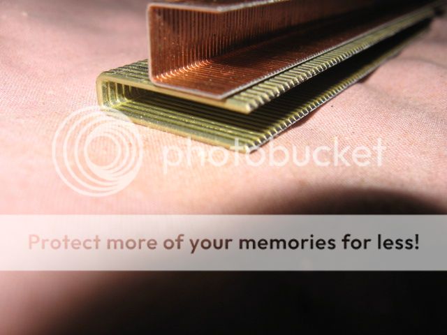

I've pulled out those 1/4" wide staples, but I've never used them. I wonder if they would work as well as gimp tacks? It would take a new gun and I wouldn't use it enough to really want to buy one.

The 1/4" (AKA narrow crown) stapler that I have uses 18 ga wire, the same as my brad nailer vs. the 22 or 23 ga. for upholstery staples.  I think they'd be a lot more conspicuous.   I use NCS for putting 1/4" panels on the back of cabinets, going through multiple layers of leather on the bottom of recliner footrests, assembling boxes, etc.
The narrow crown staple works great for anchoring double welt at corner turns. The bend in the welt serves to hide the staple perfectly. But on long straight runs, every staple would leave a noticeable "dip". You have to have some form of adhesive for long runs between turns. And like Paul points out, some vinyls just don't adhere well with hot glue sticks.
